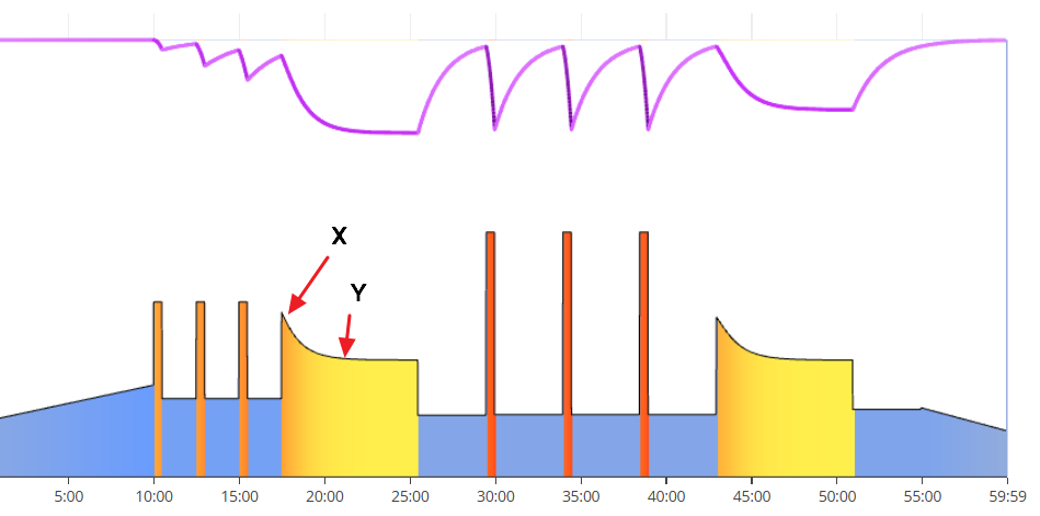

I’m not a Zwifter other than a once-a-month freebie which I often forget to do, but couldn’t you look at the workout profile on XO (Planner or Training page), recognize it’s a SMART workout with dynamic intervals and ride that workout in Slope mode on Zwift?
For example, Runnin’ with the Devil looks like this on XO –
All I need know is X and Y to closely mimic that hard start interval under my control tapering down to Y watts about a third of the way in.
Not the same as real-time adjustments EBC does in AUTO mode, but it would get the job done.
