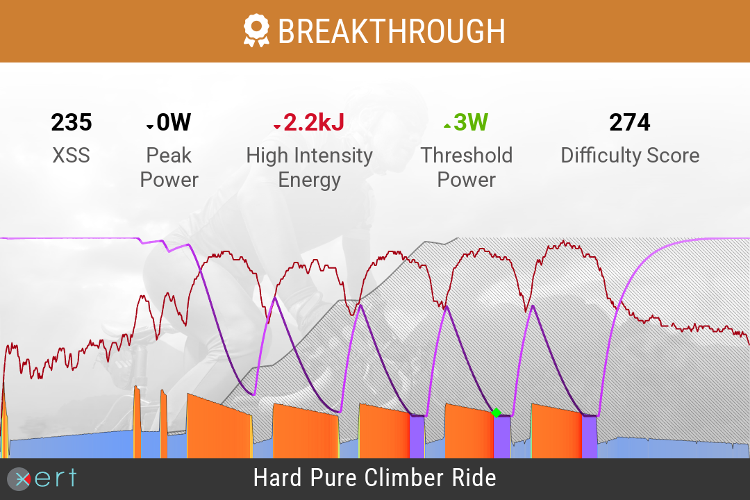

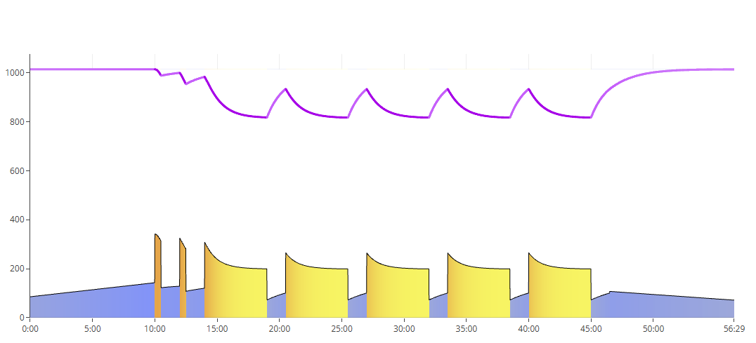

Today, I picked the XERT workout “SMART – Closer 200 (Short)” – it should be tough, but doable. So I exported it to Zwift, selected it there, and got started. In the image, you can see what it was supposed to look like: challenging, but the MPA still relatively far away – so it should have been manageable.
However, at the end of the first interval I thought: Oh my God, THAT was just the first of five intervals? Why am I so weak? Was it the avocado sandwiches? Is the power measurement completely miscalibrated now – or was it miscalibrated before on my power meter pedals?
I pushed through, but it didn’t feel “tough” – it felt like I was at my absolute limit.
Then came the surprise in Xert: my feeling wasn’t wrong. It really was at the limit. It was way harder and with a personal record of 235 XSS - double the expected amount. See screenshot.
So what did I do wrong? Does the export to Zwift not work correctly? What are the alternatives? I’d really appreciate any insights.

You didn’t do anything wrong, but Zwift can’t play some SMART intervals like the hard-start ones in the Closer series. Instead, the XSS per hour interval gets converted to a simple ramp. Those intervals will be easier or harder to do in Zwift. In this case a LOT harder. :smiley:
If you want to avoid this issue look for curvilinear profiles on the Xert chart and don’t try to ride those workouts on Zwift.
Or run EBC on your phone for this style workout. EBC monitors the effort and adjusts the target watts accordingly. To ride around in Zwift while doing so, connect Zwift to power only if you can. For example, connect Zwift to your crank or pedals for power while EBC connects to your trainer.
Another option is to recognize the workout will be harder than intended, so instead of ERG ride it in Slope mode on Zwift, tapering the target watts as strain builds. The goal for this workout is to reach a VO2max state and hang there as best you can, not kill yourself. :joy:

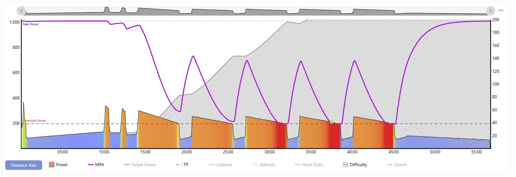

Since you flatlined MPA on the last three intervals I assume you earned a BT and the chart you posted is the pre-BT version, correct?
A BT is warranted as normally you’ll never reach a Difficulty score of 200.
Your updated “absolute limit” is applied to the post-BT analysis chart. Only one interval will show MPA touching the watts you held on those intervals.
Thank you so much, know I understand why I nearly died: it was a linear decline in Zwift and not a negative exponential one like in Xert. I suppose it would be possible to approximate the negative exponential simply by multiple consecutive linear declines, maybe that would be an worthy feature for the export module to zwift.

  1. So its only the workouts with curved power demands, right? Every linear one should be exported accurately to Zwift? Or are there more types of workouts in Xert, which will be interpreted differently by Zwift? E.g. because of different FTP setup in my Zwift profile? Or anything like that. Dont want to relive this experience :smile: Still feeling it very much today.
  2. Yes, it was a breakthrough, but only minor (+3 TP). Can you please elaborate on your comment about the high XSS in 56 minutes? Is it still plausible with this only minor breakthrough or does this high XSS indicate some problems with power measurement of any kind?

I was talking about Difficulty level which is function of XSS per hour.
Normally the shaded portion of the chart (Difficulty score) will never exceed 200.
See: Difficulty Score – Xert
Try this experiment –
View the activity details, raise the TP value below the chart a few points, then click Refresh.
How many points above current TP do you need to go before the MPA line just touches one of the intervals? Purple sections will turn to red and shaded portion of chart should drop below the ceiling (200).
