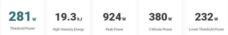

I get the feeling that it is a very short window. That would explain why XERT overestimates my TP by approx 25w. For a light guy like me, that’s about 0.41 wkg
I had the same issue with intervals.icu with their default value they have. Since I am more anaerobic than aerobic phenotype it also gave me unrealistically high FTP in the beginning, only because my short burst power numbers are relatively high, vs my FTP/TP. Now I set that timer in intervals to 410 seconds and it is much more aligned with what I can actually do over longer durations. Is it possible somehow to tell XERT to use a larger min-window to calculate my signature profile?
If you do some very short all out efforts to breakthrough, it should increase your PP and HIE and reduce TP automatically… is your PP correct? Interesting to know your overall signature, and you can check that vs some rough norms

I think above TP, PP, 3min Power are too high, approx 20-30 watts.
HIE is maybe too low but I am not sure about that.
