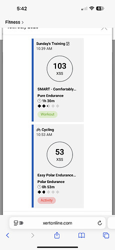

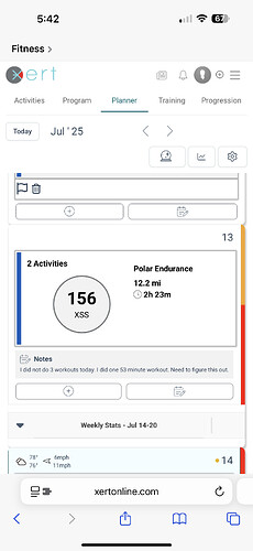

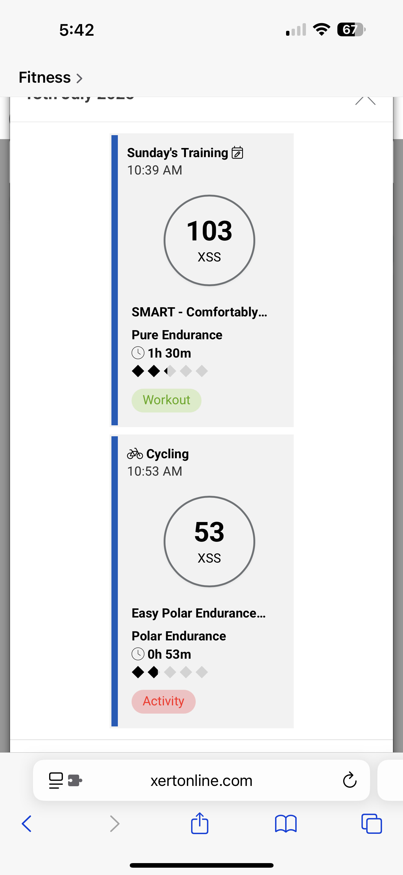

I still can’t seem to get this part figured out. I only did one workout yesterday (the lower XSS one) and it shows I did two workouts… Why is a workout that was picked by FAI but not completed showing as completed?
What is your time zone?
A workout on the Planner that is never executed is cleared after midnight each day.
Or you can manually delete the entry if you have decided not to do it.
Mountain time. I’d think that by 5:42pm on the following day, any uncompleted workouts should be gone from the previous day…
If that entry got tagged as a completed activity, I suggest you file a ticket with support@xertonline.com and they can take a look at your account.
