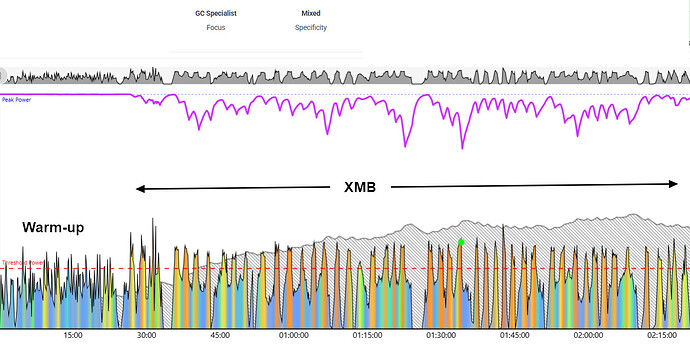

Example (Mixed GC Specialist) –
I picked a route that allowed this consistency. An out-and-back section on the Blue Ridge Parkway with no lights/stops and little traffic. YMMV
Difficulty Score was based on a high of 97 (3+ diamonds = Difficult rating)
