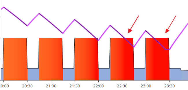

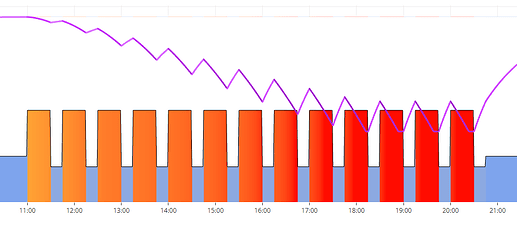

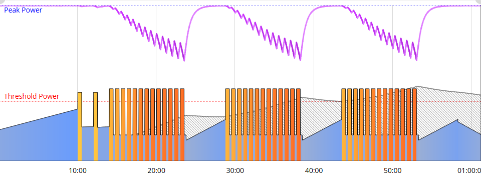

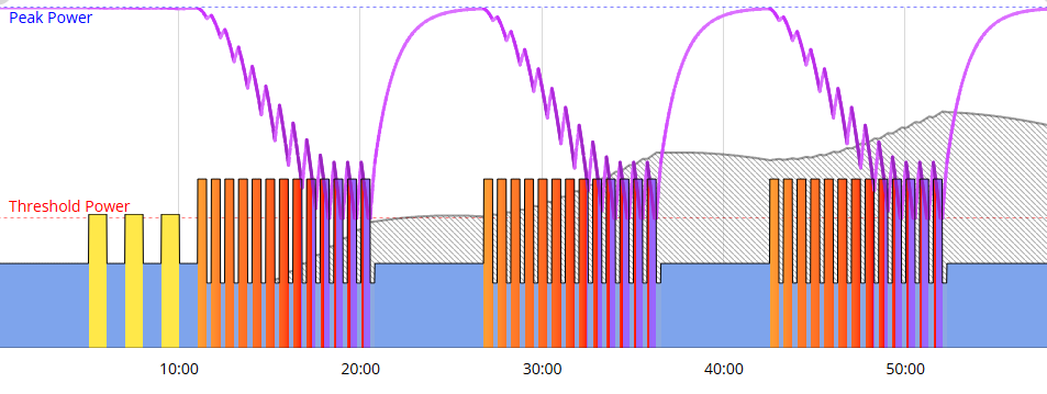

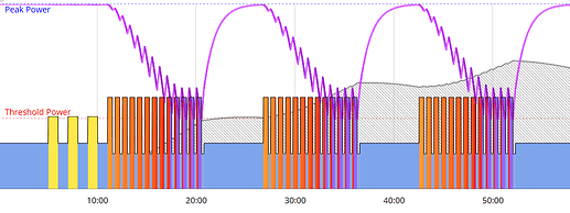

You can prove that next time by riding the Ronnestad sets continuously in Slope mode, extending duration or upping watts or adding another interval until a failure point is reached by the end of each set.
Cheung should force this issue if your signature is valid –
You want the same to occur with A Pain for at least one set –
1 watt is normal noise. So is 5 watts down if decay does its thing without sufficient rise in TL or punching through MPA now and then. Those punches can be anywhere along your curve.

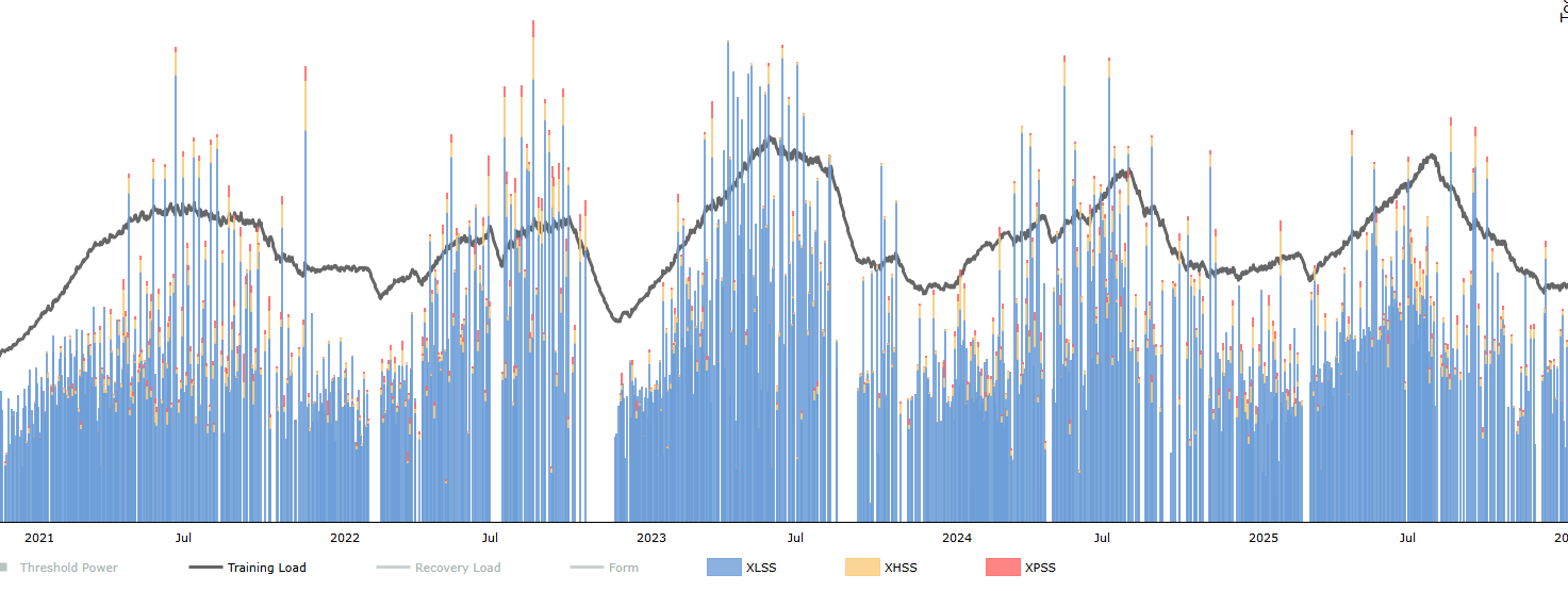

How much downtime do you schedule during a season?
How toothy are your year-over-year progressions? (TL deltas)
Here’s my five peak 5-year profile (XPMC set to TL) –
These are all BBP progressions including periods of rising TP due solely to the increase in TL.
I did insert BT efforts occasionally on HIT days if the 3-week warning appeared.
