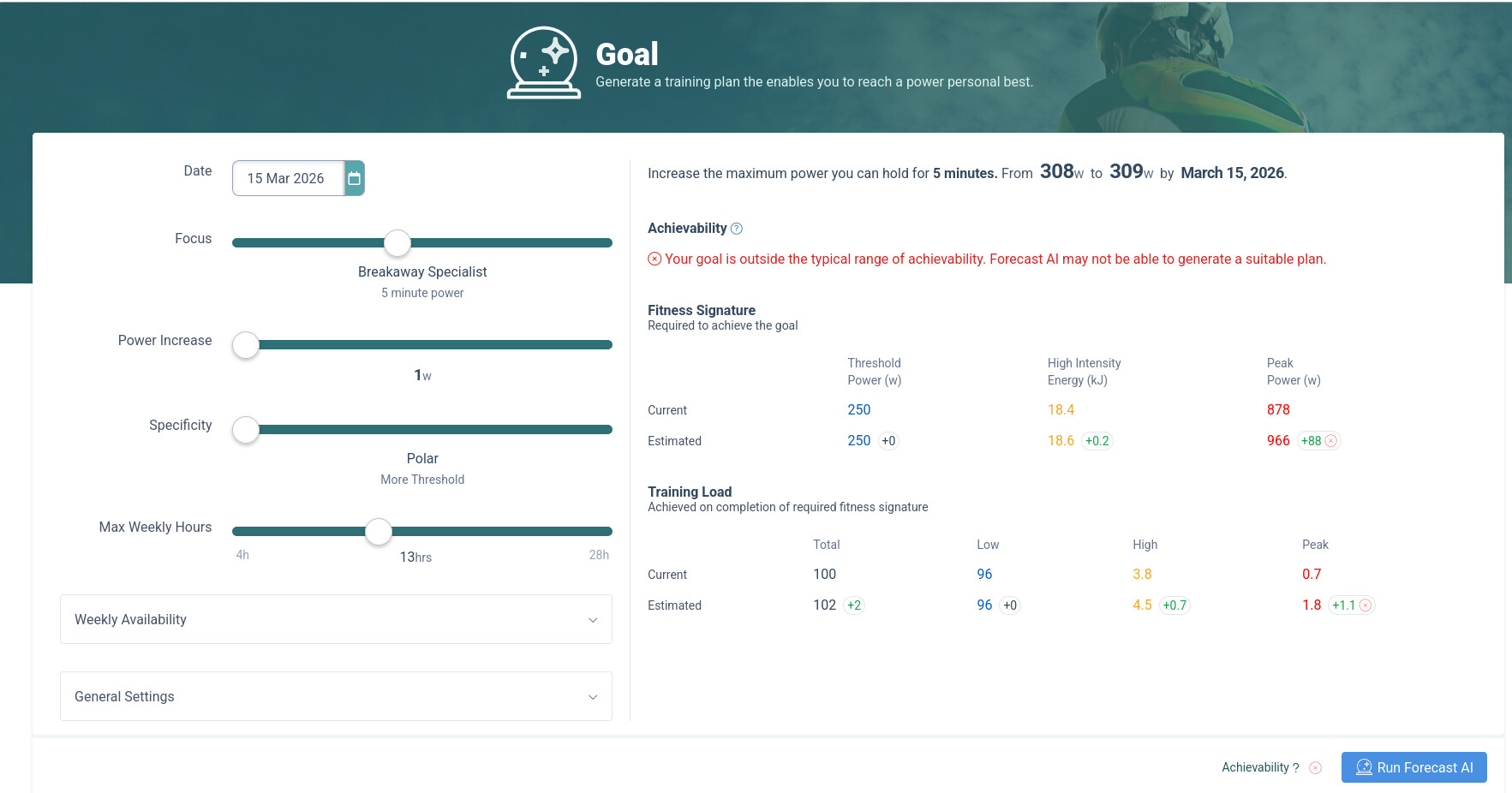

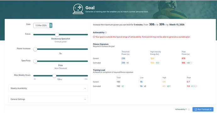

But now, as the B-B-P program ended, I switched to a Breakaway Specialist focus, wanting to do more “punchy” workouts. Whatever the program I select, Xert doesn’t project anything positive. For ex., I can’t even hope to gain 1 W:

Anyway, I selected the program “Goal”, “forced” it to gain 18W by March, 15th, and the Planner is filled with “Low Intensity Training/Pure Endurance” and only 1 or 2 “High Intensity Training” per week. It seems very light for a “Breakaway Specialist” focus. I had more intensity workouts during the last Build-Peak phases for a Climber focus.

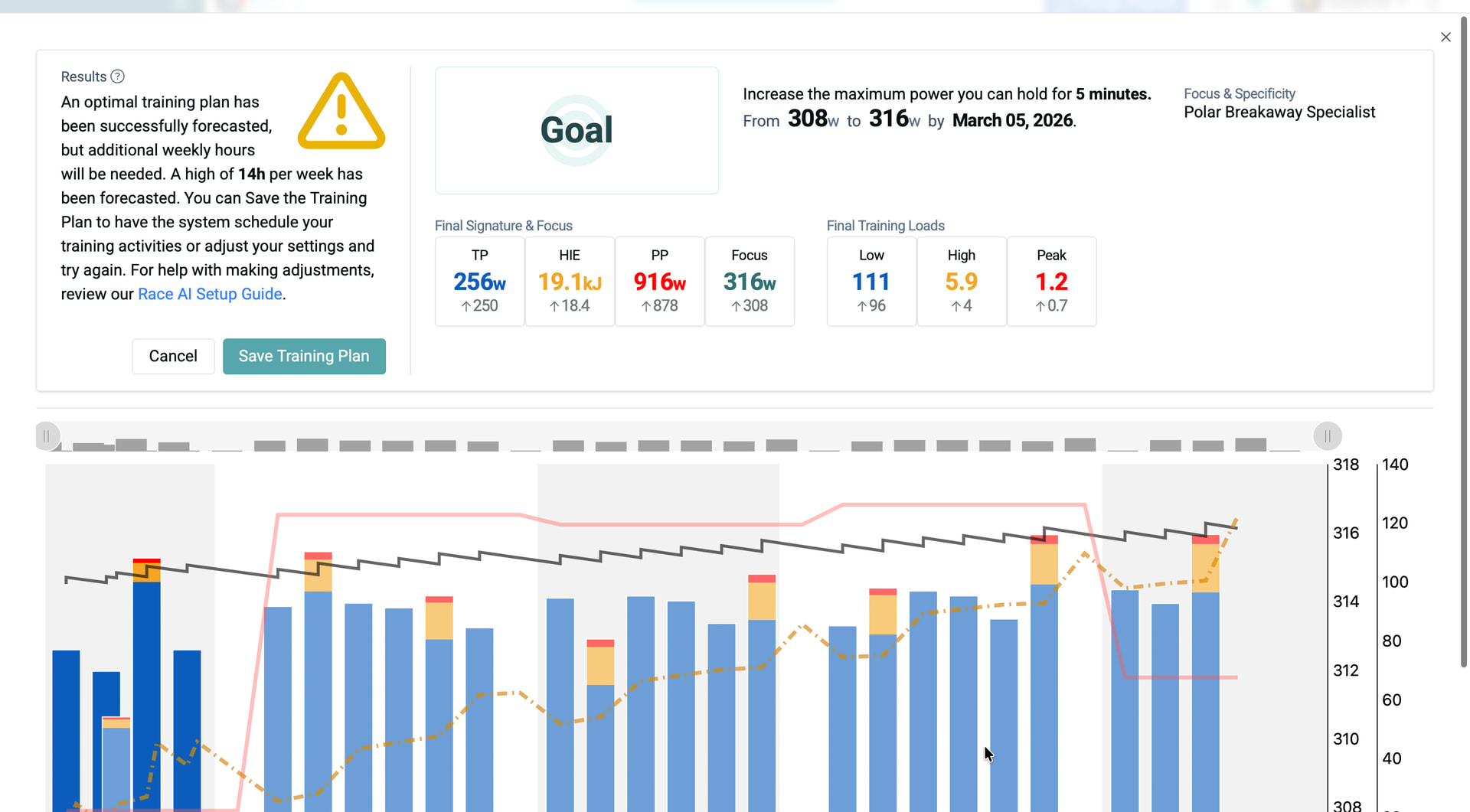

Thanks for your message - and I can appreciate where you’re coming from. I had a look at your screenshots (and your account), and it actually shows that you’re sitting at nearly 4-star training status with a Training Load of ~100, which is already quite high. What this means is that you’ve more or less hit a fitness plateau based on the amount of training time you currently have available.
In short: to continue making progress - especially in areas like 5-minute power - you’ll generally need to do more than what your body is already used to. And if your available training time is maxed out, then we wouldn’t expect significant further improvement unless something changes.
There are a few tweaks that can help you squeeze more out of your current schedule:
  • Increase your XSS per Hour setting (e.g. from 100 → 120)
  • Adjust your polarization ratio (e.g. from 4:1 to 3:1)
  • Reassess your Max Weekly Hours, if there’s any room to bump it slightly (try adding an extra ~30 min twice a week, if possible)

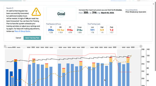

In fact, when I tried those adjustments, I was able to forecast some improvement in your 5-minute power:
Also worth noting: it’s been about three months since your last Breakthrough, so your current fitness signature might be underestimating what you’re capable of. We often suggest trying to get a fresh Breakthrough before starting a training program; otherwise, your plan may be aiming too low.
Finally, it’s true that high-intensity workouts (HIIT) are efficient at building fitness, but they require more recovery and can’t be done every day. That’s why, as your training status improves (e.g. as you accumulate more stars in your Xert profile), endurance riding becomes more important - not because it’s magical, but because it’s a very sustainable way to add volume (e.g. XSS) without overloading recovery demands. Of course, that means more time, and… well, that’s just part of the sport sometimes!
