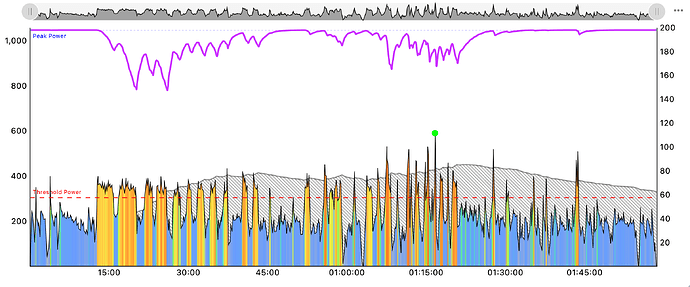

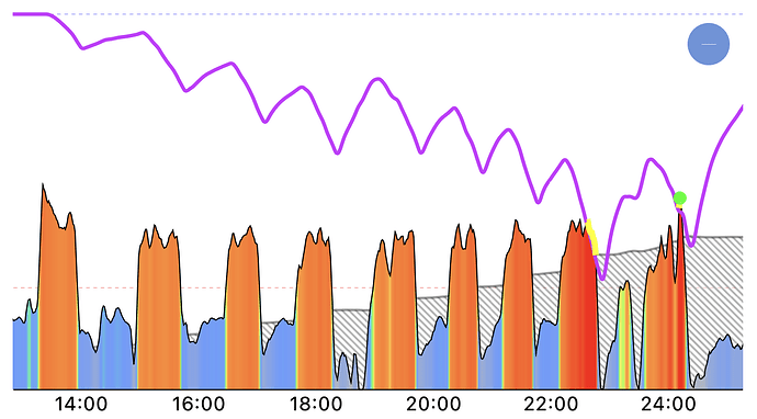

I use XFAI, so on high intensity days I look at the planner an open the workout and read the description. It might say focus on short hills - so that to me is 1-3 minutes long. It might say focus on longer hills so 8-10 minutes. My next high intensity day says punchy accelerations which will improve your ability to tackle shorter hills. Focus on pushing hard while standing. You should feel out of breath at the end of each set but not totally gasping for air. Alternate between staying seated and standing, with cadence being a bit faster than normal.
I use the descriptions to tell me what type of high intensity day it is and use MB outside to deliver that
That’s a very interesting approach - thanks for sharing. Do you ride indoors as well? Do you mind sharing your indoor approach?
Thanks for sharing. How do you get your buckets filled. I find myself either following what XMB on Garmin tells me or going with the terrain and traffic. So catching the green light or going uphill equals going hard. It’s fun to ride like that but I feel that is totally different to nailing a traditional workout where you feel the 9/10 RPE in the last set.
I have a love/hate relationship with the trainer and currently in hate mode, so all my riding currently is outside and has been for a long while. But I guess I would do the same. Read the daily instruction and then choose a workout to suit.
it depends. Some days I don’t have much motivation os will tend to do sprints between 2-5 telegraph poles and see how I go - so short sprints. Others I will choose to kill-the-hill so longer efforts and see if I can get a breakthrough. With endurance rides I also vary from LTP and below, to tempo low cadence efforts and occasionally below LTP and throw in a full on 10 second sprint every 5 minutes or so, depending no terrain
The first 10-15 minutes I ease into the ride, maybe a sprint effort or high cadence effort. Then I look at the target watts on XMB and start a first interval. I don’t mind the interval time prescription, just focus leg burn / breathing. I stop when leg burning is rising exponentially. I start the next interval as soon as I feel the next one should be possible for my lungs. Usually a lot earlier than XMB pause timer. On a good day, I will try to stay below CL 8 until about 2-3 HiE are left, on a bad day or after a recent breakthrough I struggle to keep CL 3 until the end.
I use breathing as a clue for VO2 training effect. LIT = nose breathing, MIT/Threshold = strong mouth breathing, HIT = moaning, feels a bit like suffocation as CO2 levels in the lungs are rising faster than I can breathe them out.
On a very good day: in the last 3-5 intervals I push my intervals until i can not keep the target power and shorten pauses even more. As I reach CL10 I will push my efforts through declining power. I keep going RPE 10 until my power drops below MPA. After breakthrough: short pause at LTP and another all out push above MPA for as long as possible - burning all my matches for today and finishing with the low intensity part of the ride (usually at around 60% TP, even when XMB adviced 75%).
Sometimes my breathing is harder at lower CL. Sometimes my legs are too weak to reach that state. I will either cancel and go low intensity or I go CL2-CL3, but a lot more intervals. These have been the rides where I accumulated the most KJ above TP and finished with really high NP. These “bad day completions” usually give me a lot of mental confidence instead of making me worry about progression.
Typical breakthrough session @450W:
”bad day completion”:
