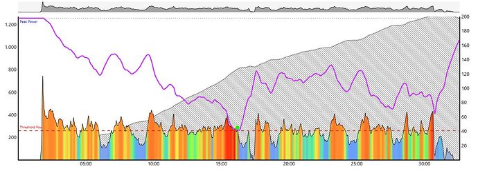

I recently used XSH on an ~11-minute segment (into a nasty headwind :sweat_smile:) and it helped me pace to a near-Breakthrough. Different duration than your 10-mile TT, but the pacing principles are very similar. Ideally, you see a slow, gradual decline in MPA over the course of the effort, and that MPA comes down to your power output near the end of your TT:

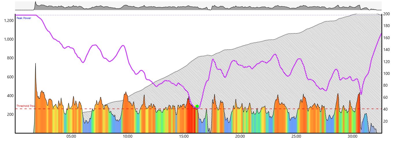

If you want, share your MPA chart from your first TT! It would be really interesting to see it!

Can you see the attached ?
Yes, Perfect! It looks like you were right at your limits around the ~15 min mark and still almost reached your MPA a second time near the end - that’s tough to do! Well done! Because of the pacing, notice how high your difficulty score was - that’s the hatched line in background.
The closer MPA & your power are, the faster difficulty score will shoot up. That’s why going out too hard is very punishing: by going out too hard, you pull your MPA down quickly, so you need to either push through (extremely challenging & requires mental toughness) or you ease up and partially allow MPA to recover, at the expense of a longer/slower finish time.
There was a brutal headwind on the out leg, so tough :tired_face: :face_vomiting: in my naivety I lit every match in the box thinking the tailwind would get me back home, so if the second part of the ride shows anything like recovery it was a helping hand from mother nature.
Another issue was because the setting sun was so low in the sky I didn’t have my reading glasses on so couldn’t read my garmin :laughing: you couldn’t make this stuff up :rofl:
