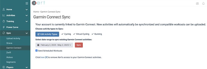

stuyd Yes, Garmin Connect is supported. See margin in pic for all supported connections.

So I have just completed a ride over the iOS app and uploaded. However it has not appeared on my Garmin connect home page.
It downloads completed activities from Garmin, but not the other way. Workout definitions are uploaded to Garmin.
In order to upload completed activities you can use RunGap. It allows you to sync activities from Strava to Garmin Connect.
Alternatively, you can manually upload the activities to Garmin connect.
