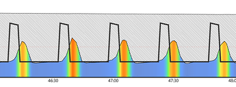

Why would you want to do this? ERG Control (AUTO mode) doesn’t ensure intervals match their intended XSS points. Depending on your trainer’s responsiveness HIT intervals may look like this.
Or a lot worse for short spiky intervals like this.
The longer the workout set the more those missing points add up.
To see how much your trainer response affects your intervals, take a look at your past indoor HIT workouts and enable Target Power on the chart. Then zoom in.
