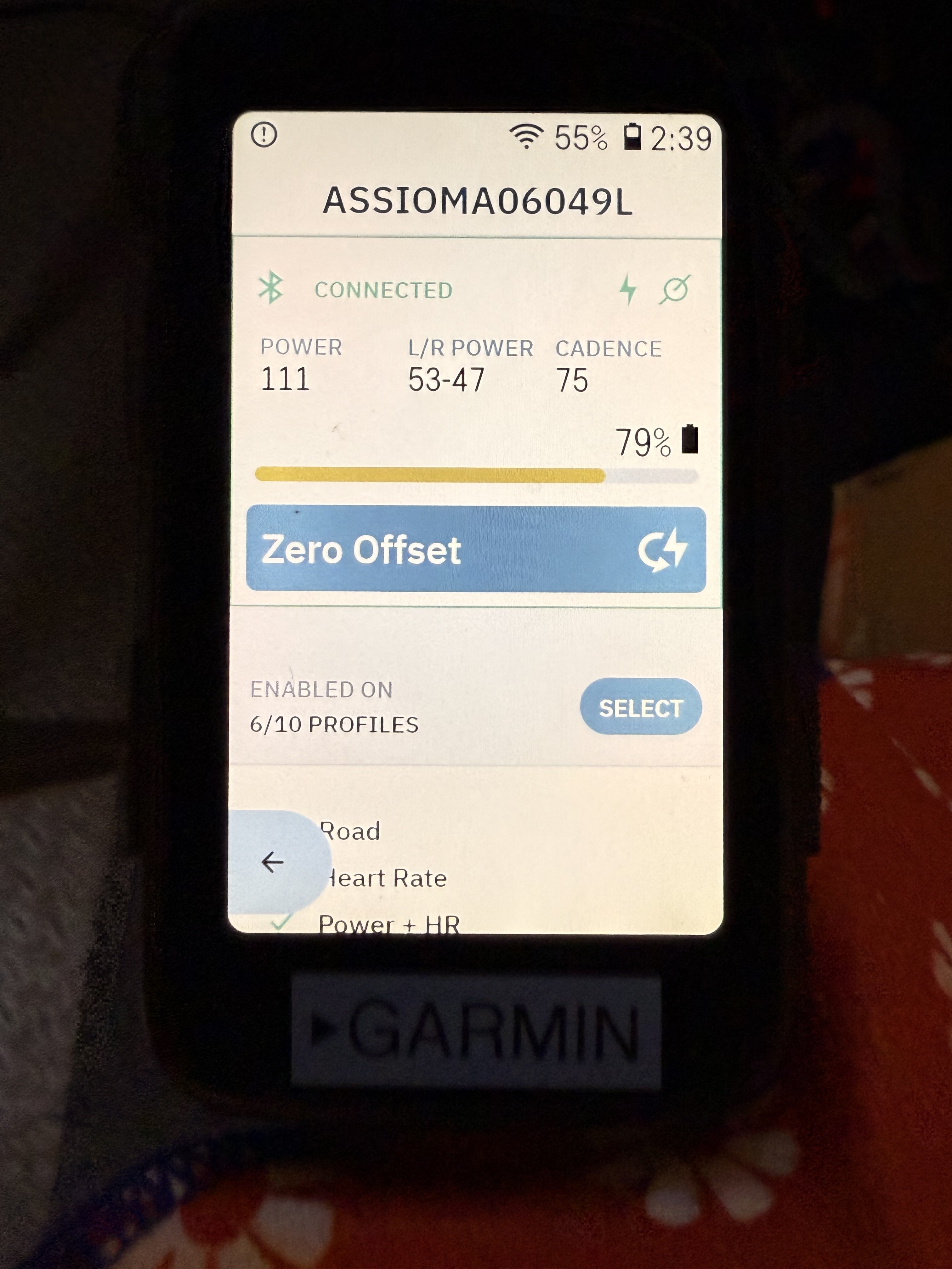

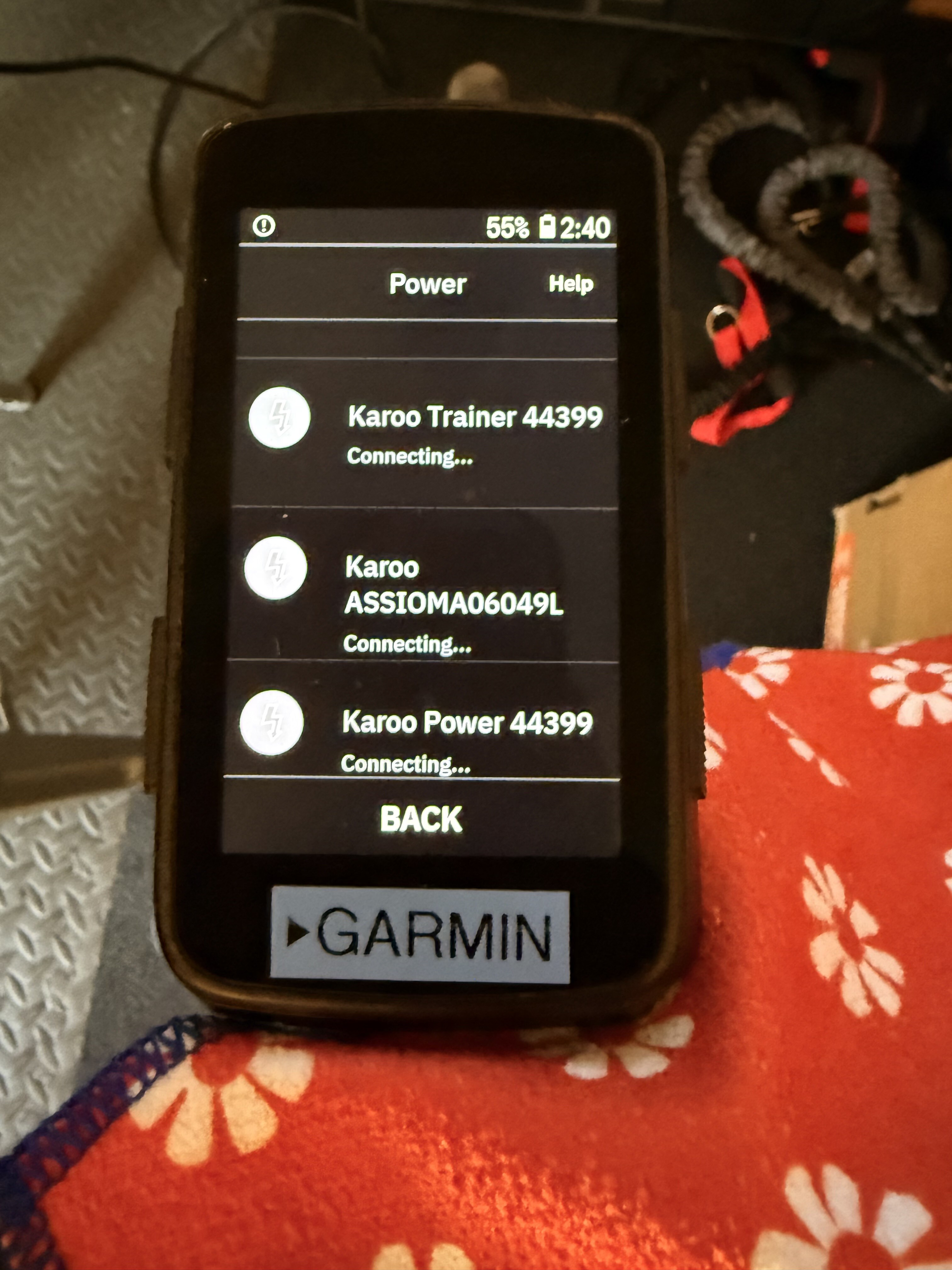

I can’t get EBC to recognize my power meter that my Karoo is connected to. It shows the power data on the Karoo data screen but won’t connect in EBC
I can get it to connect at various times but it keeps disconnecting. I’m on my trainer and connecting to my power pedals.
Reinstall.
Thanks. I tried updating the app to the latest version showing up in Extensions and will test it tomorrow.
