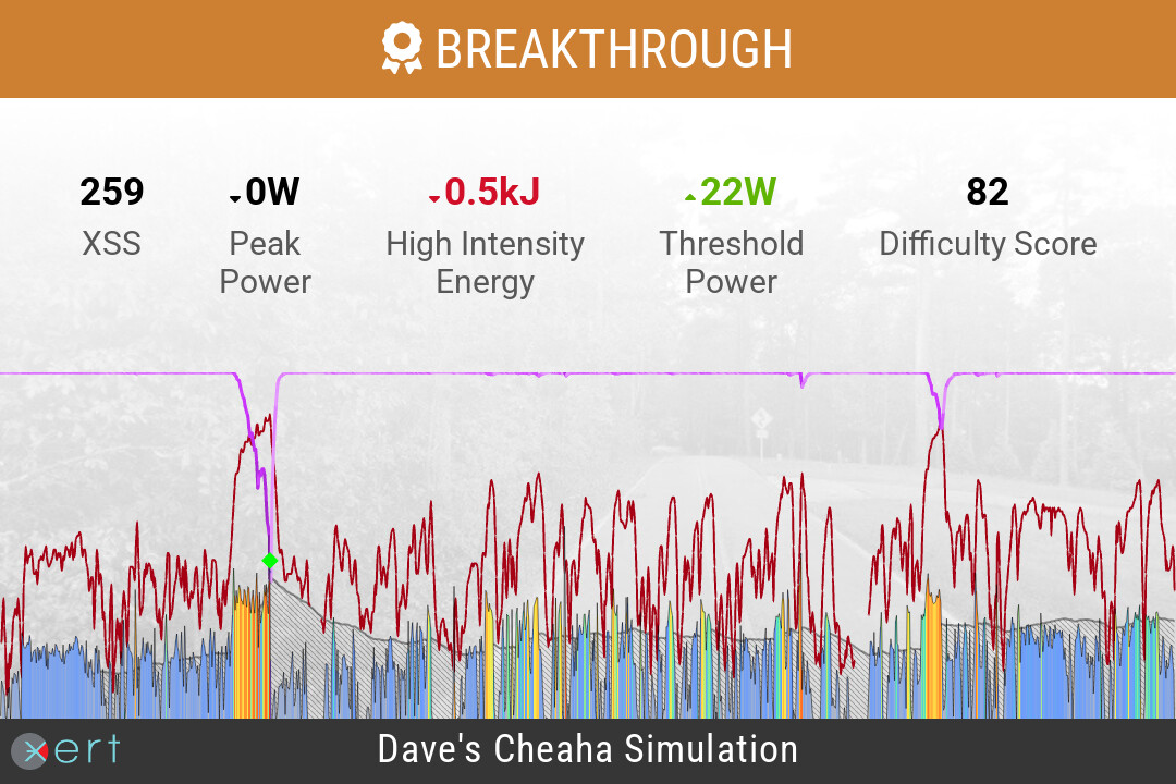

Attached is the breakthrough report.

That KOM attempt included an abrupt stop (vs natural failure) where the BT occurred.
That is a common source for an inflated signature bump.
You can flag the activity to remove the signature recalculation.
You can also manually adjust the numbers below the chart to what you consider a more reasonable bump, run Extract, then Save.

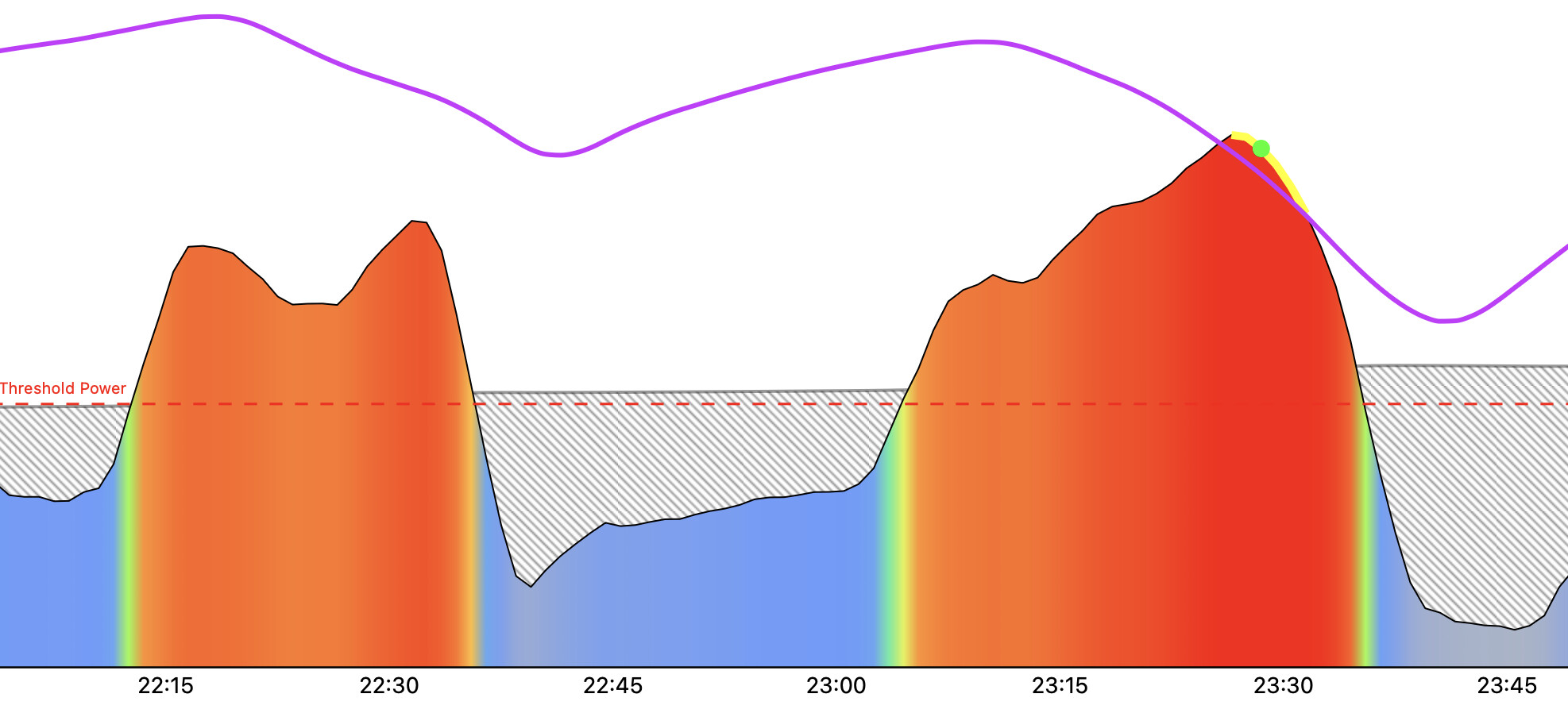

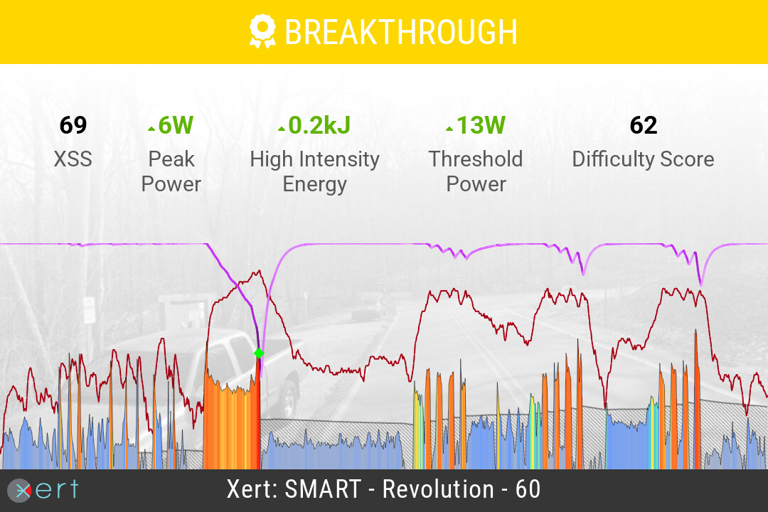

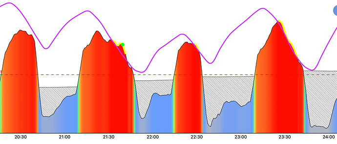

It’s not about short efforts, it’s about pushing them until the end. It’s not the raise but the decline in power which will set the new signature. The steeper the decline, the more TP and less HiE. If it is flatter, HiE is predicted to be higher. Backpedaling right out of a max effort will increase TP in an unrealistic manner as the system calculates that your HiE-tank was empty at that moment.
Two breakthroughs from myself to compare:
First one is a breakthrough where I stopped pushing with a bit of stuff left as soon as I could not hold power any more. You see the powerline was a lot steeper than the MPA-line. This gave me a big TP increase and HiE decrease in the breakthrough:
second one is a more realistic one, especially the last bout where my real power keeps pushing almost until my all out power fell to TP. This did hurt for sure, but only for two minutes and it gave a more realistic signature. HiE also increased as expected.
tldnr: The longer you push into your declining MPA the better the resulting signature will be.
