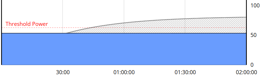

Zone 2 Pacer is a 3-diamond workout rated Difficult. Note the rising Difficulty Score after 30 minutes (to 80+).
That’s calculated from the defined interval of 100% LTP at 1% Slope.
Even if your LTP value aligns with your actual LT1 (and you’re riding below it) that is a tiresome effort at 2 hours.

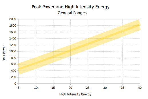

…which is very low for your TP. Expected is about 30 HiE.

Isn’t a HIE of 30 really high for a peak power shy of 1000 watts?
