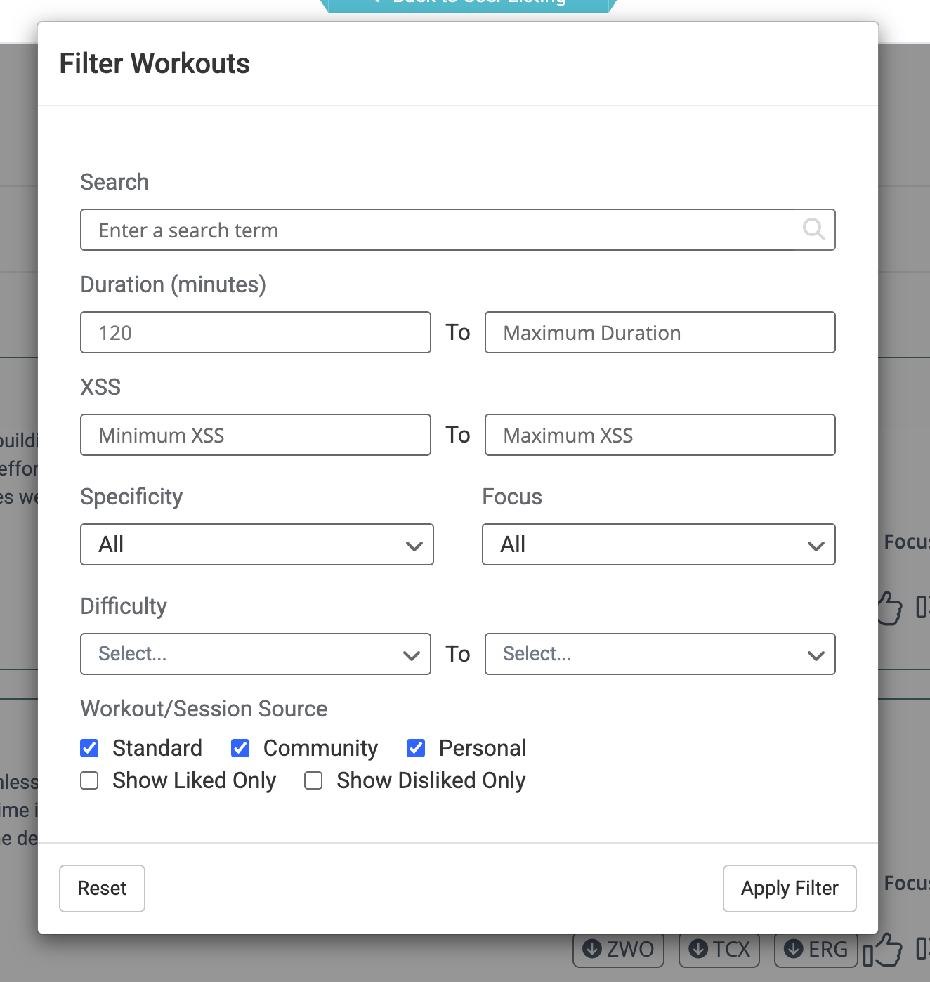

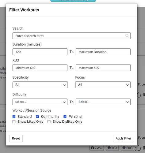

How do I find workouts that are 2+ hours long? I have my availability set to 2 hours during the week and 4 hours during the weekend, but the workout library only seems to contain workouts up to 2 hours.
Use the filter option:
When I use that filter option, I only get workouts that are 2 hours but not longer.

If you’re interested in longer workouts, you can make a copy of a longer workout and then modify and make more copies as desired. These will then show as a recommended workout in your profile.
Are you using XATA or XFAI?
Do you mean indoor HIT workouts over 2 hours long or endurance level rides up to 4 hours?
Do you ride mostly outdoors on weekends or do you ride that long indoors?
The Workouts Library does thin out over 2 hours in duration, but any workout can be extended in a few clicks using Workout Designer, Copy, Edit, and Save to your Personal folder. As mentioned, those workouts will also show up on recommended lists when suitable.
