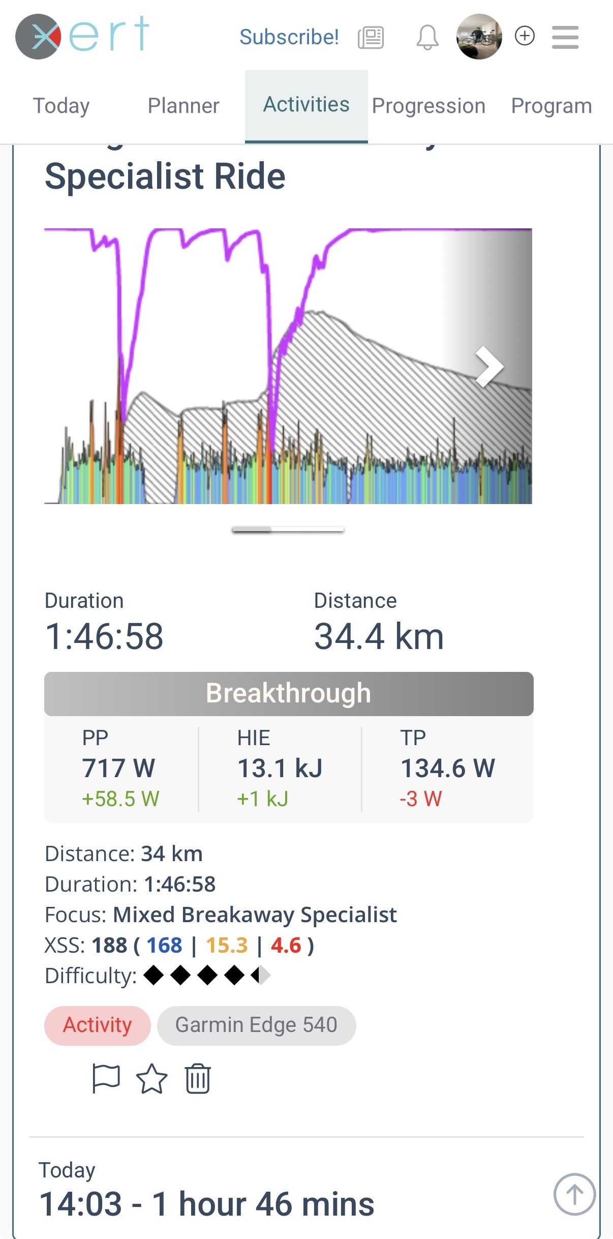

Why my TP is going down after an outside ride with two Breakthroughs? I don’t think I understand everything yet.
Your signature will float up and down based on changes in Training Load (TL) and signature adjustments from Breakthroughs (BT events).
A BT includes one or more changes to your three fitness signature values.
A BT can adjust a value down to align the numbers with the signature algorithm.

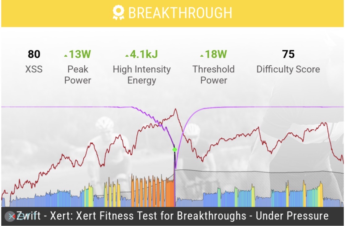

That was a silver BT with two values going up and one down.
If you don’t agree with a BT adjustment you can flag the activity which retains the strain analysis but skips the signature calc.
Your signature is recalculated after every activity or lack thereof (signature decay).
The goal is for your signature to be in the right ballpark for training purposes.
You can monitor your TP trend up/down over time by viewing XPMC under the Progression tab.

The BTs were already fine. If I understood you correctly, this will settle in and the TP will then go up again. I was just surprised because my last FTP ramp test on zwift was at 164.

The change in signature represents what your fitness was on that one ride. Try and hold on a bit longer or push a bit harder at the end next time to get those couple of watts back! :slight_smile:
I think my signature is now dialed in :blush:
It’s definitely a bit annoying to see the numbers dip, but in Xert, a small daily decline is actually normal if you’re using ‘Optimal Decay.’ The system assumes your fitness is ‘stale’ if you haven’t pushed to a breakthrough (BT) recently, so it gradually lowers your signature to make it easier for you to hit a breakthrough the next time you go all out.
If you aren’t planning on doing a max effort or a Zwift race every few weeks, you might want to try switching your decay setting to ‘Slow’ or ‘No Decay - Training Load Matched’ in your profile. That keeps your TP more stable based on your training volume rather than expecting frequent breakthroughs!
