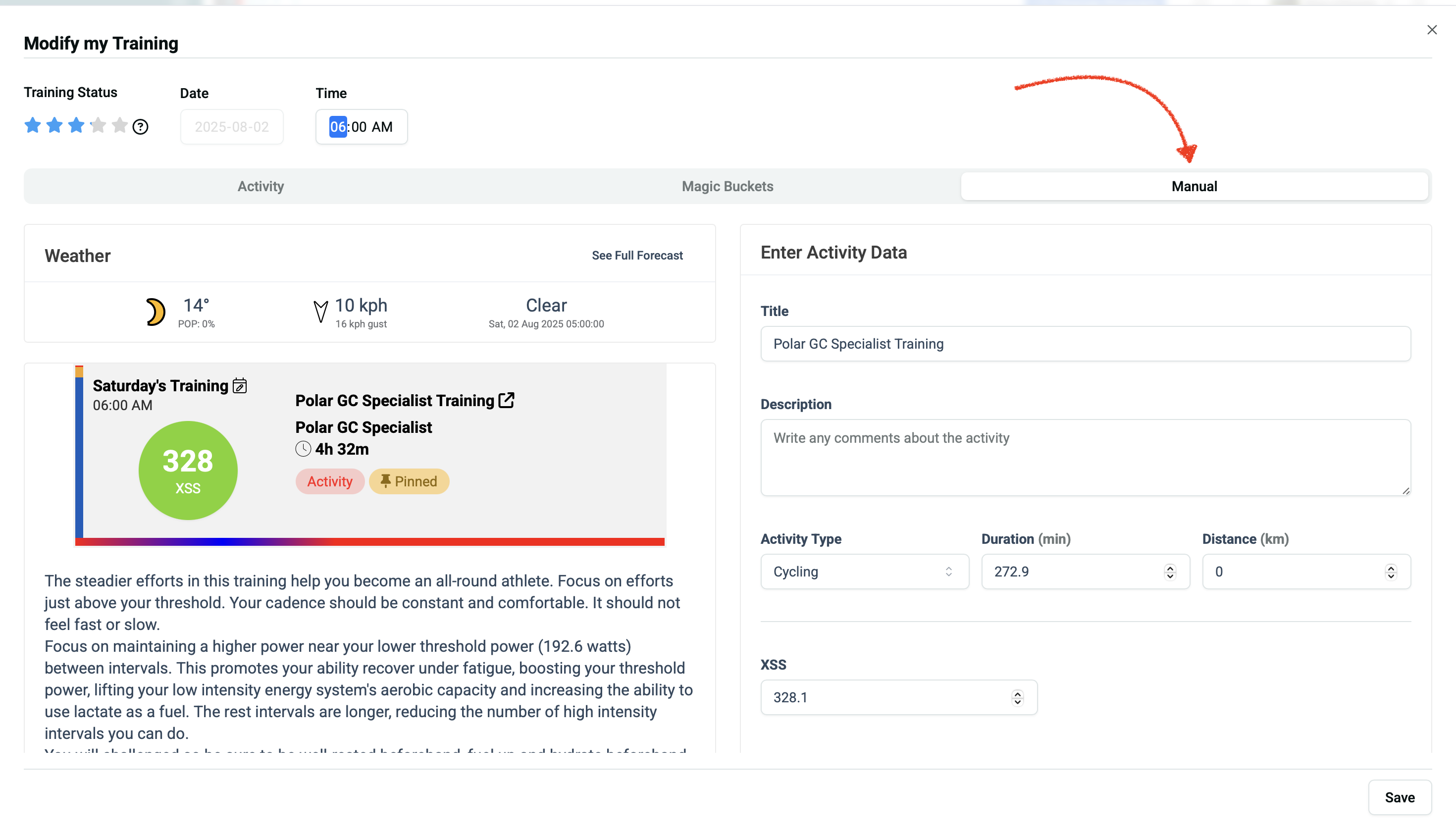

Use the ‘Select Training’ option on the Rest Day placeholder like you would for any other training day, then toggle to the ‘MANUAL’ tab of the modal:

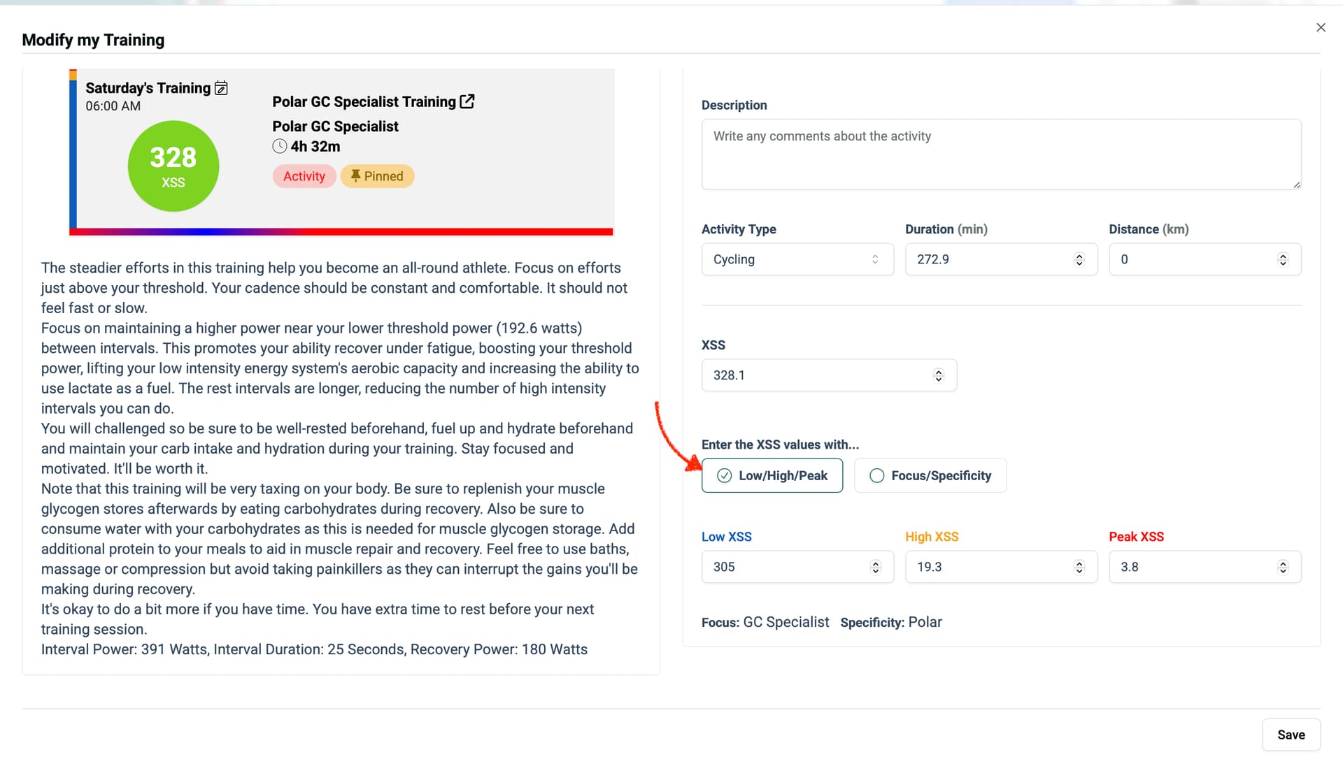

This will allow you to manually enter your estimated Low, High, & Peak XSS for your race, or the Total XSS + Focus & Specificity:

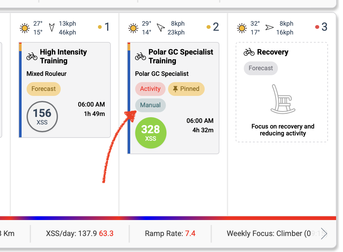

Once saved, you can pin it from the planner & Adapt Forecast around it, like so:
