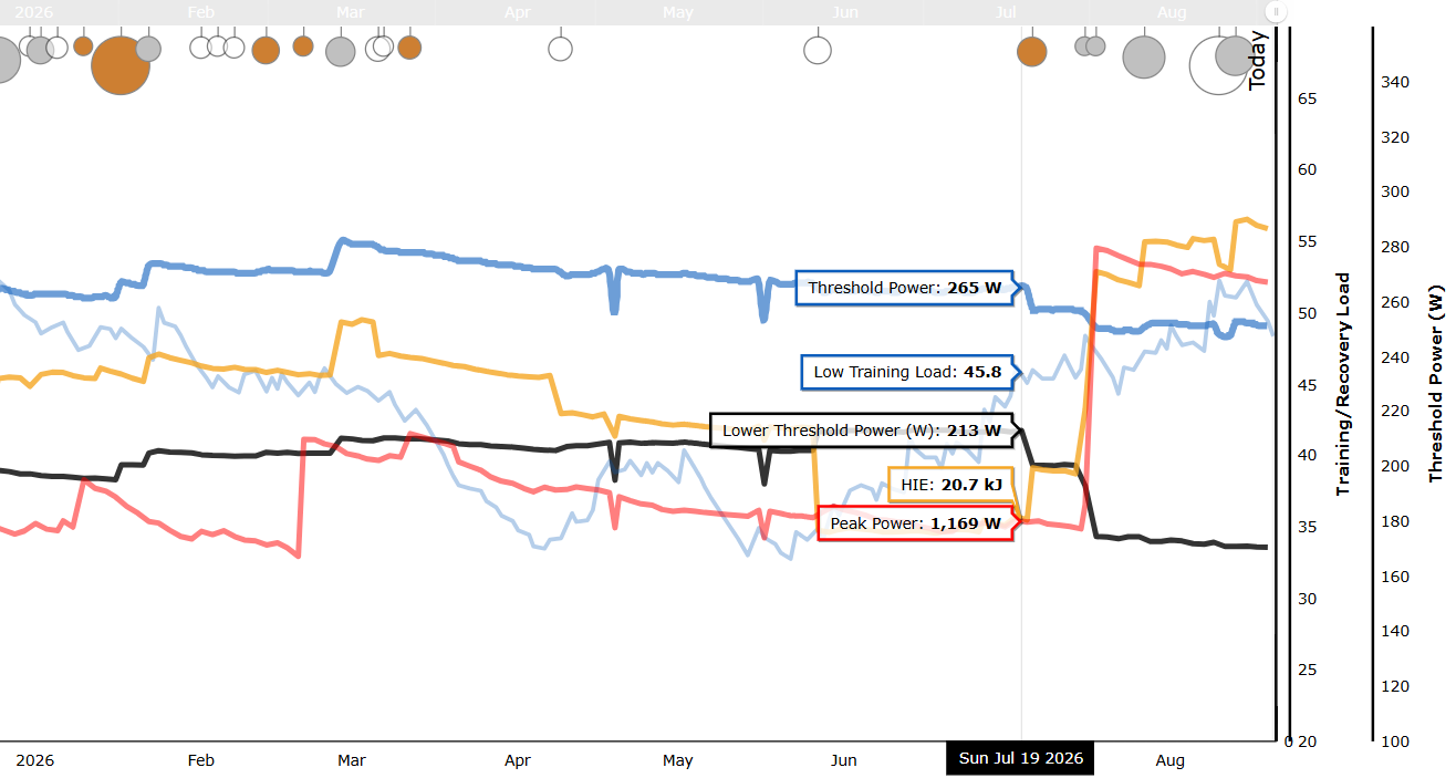

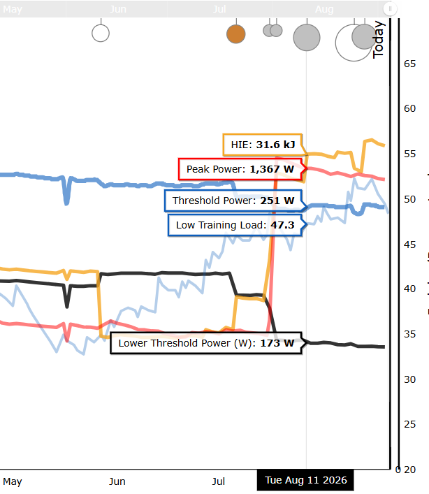

After changing it up with some sprints and Vo2 workouts for 3 weeks, my signature changed significantly. (Kindly see chart below)
I understand that because my PP and HIE went up, now LTP down. (Xert calculation)
Is this physiologically sound? Will LTP be calculated the same in Xert 2.0?
Carbs /fat calculation is totally different now, workouts are different and I now suddenly don’t know what to trust? (LTP is 40w lower all of a sudden.
My physiology could not have changed suddenly, yet i know PP is correctly measured. i didnt sprint/ do VO2max work for months) so it was “falsely low”… I want to be more efficient “aerobically” but with a sprint/ intense workout my LTP will drop. Will my LTP ever go up? If i flag the workout, then the PP is inaccurate.
@xertedbrain @ManofSteele
If you were in my “saddle”…. what LTP will you use to train at? LTP 213w ? 173w? (40w difference).
Should i manually adjust Xert LTP based workouts now?

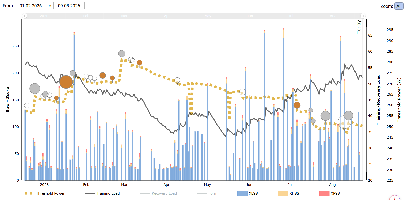

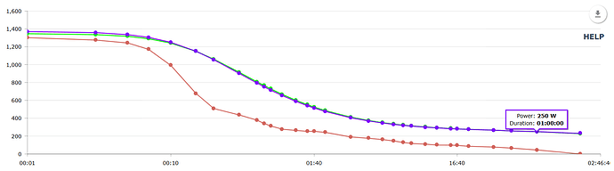

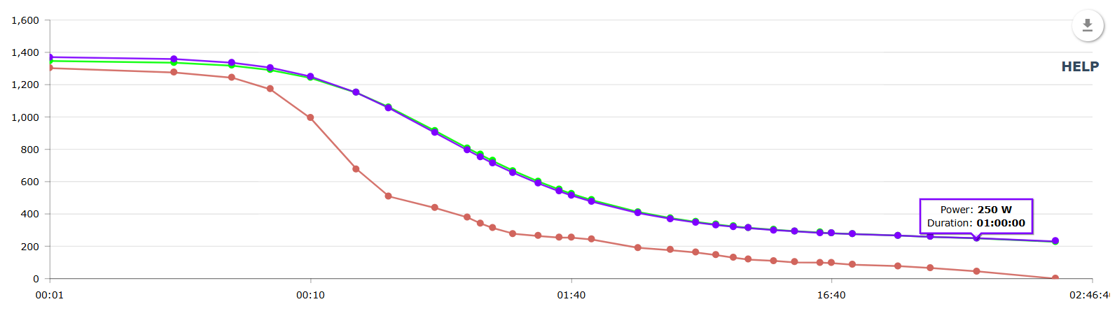

You posted the “what” chart. Let’s see the “why” chart. (YTD XPMC)

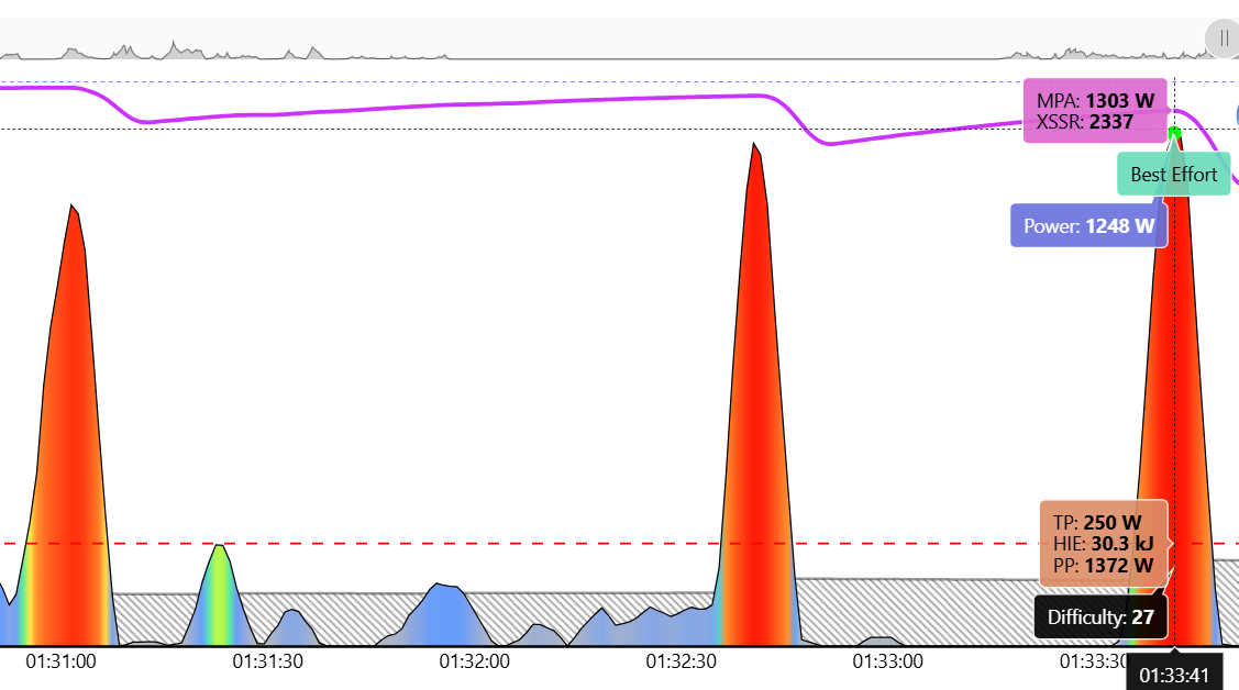

Also post the BT report and power chart for the activity where the jumps occurred.

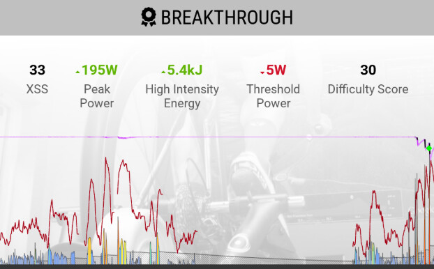

This was very relaxed ride with my boy, and ~5 sprints at the end.

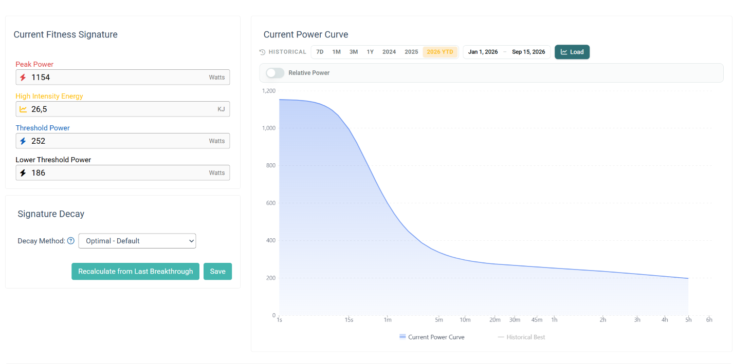

Same story for me. I’m the same type of rider (high HIE and PP, low TP). Xert has always underestimated my LTP (measured via lactate testing at 213W), and I honestly don’t know how to align Xert’s metrics with real-world data. BTW, I did a 20-minute FTP test and it showed 280W (in intervals.icu) but Xert set 262 on that test.
I don’t think I’d trust a “relaxed ride” to dial in my signature. :slight_smile:
I’d probably flag or edit that activity rather than accept the change to both PP and HIE.
If you zoom in on the five sprints how many secs long, how close in watts, and were you fully rested between?
IOW were they truly a series of max effort sprints to validate your PP?
Have you replicated the new PP since the adjustment?

Based on your XPMC I suspect a latent TP bump is in the wings. If that’s the case your LTP will be higher.
The abrupt dips in TP back in mid-April and May seem odd. :thinking:

Thanks for the reply. I was playing around, not racing. But they were 8-10sec sprints. (see below) I did not flag the activity because i haven’t done sprints for a while and there is nothing wrong with the data. So, I believe the PP data is accurate.

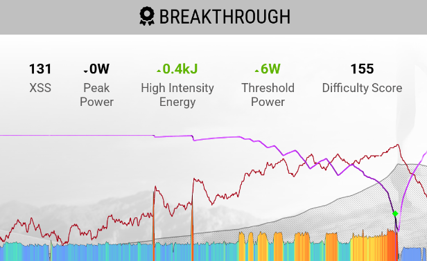

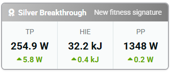

This was 3 days ago: Longer efforts to breakthrough. Gained ~6W TP… LTP still ~174w. I’ve accepted it. It will “correct” with time and other breakthroughs.
