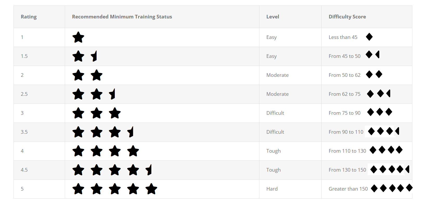

XSS per hour establishes the Difficulty level achieved on any workout or ride.
Easy endurance and recovery pedaling is 50 XSS/hour or below.
Moderate rides are typically ~60 XSS/hour.
75-110 XSS/hour moves you into Difficult rating territory.
Point being there is a sizable strain difference between 200 XSS spread over three hours than two. 200/3 = 67 (2.5 diamonds) versus 200/2 = 100 (3.5 diamonds). You’re going to feel that difference.
3.5 may push your high/peak recovery further into the following day(s). If so, an Adapt Forecast warning will appear if you’re on an XFAI forecast. If you choose to adapt, the previous endurance day may change to rest/recovery recommended.
The warning dot appearance will depend on where you’re at TL-wise. For example, if you’ve been riding at 3.5 to 4 status stars for a while, a 3.5 Difficulty workout isn’t going to phase you much. If currently at 2 stars a 3.5 diamond workout will push you into red longer. Your recovery form will reflect red to yellow into the next day (or more) instead of a shorter recovery from red to blue had the strain been at 2 to 2.5 diamond level.
