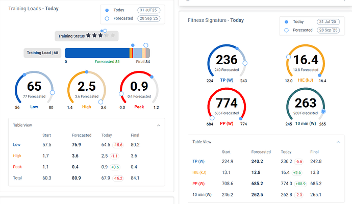

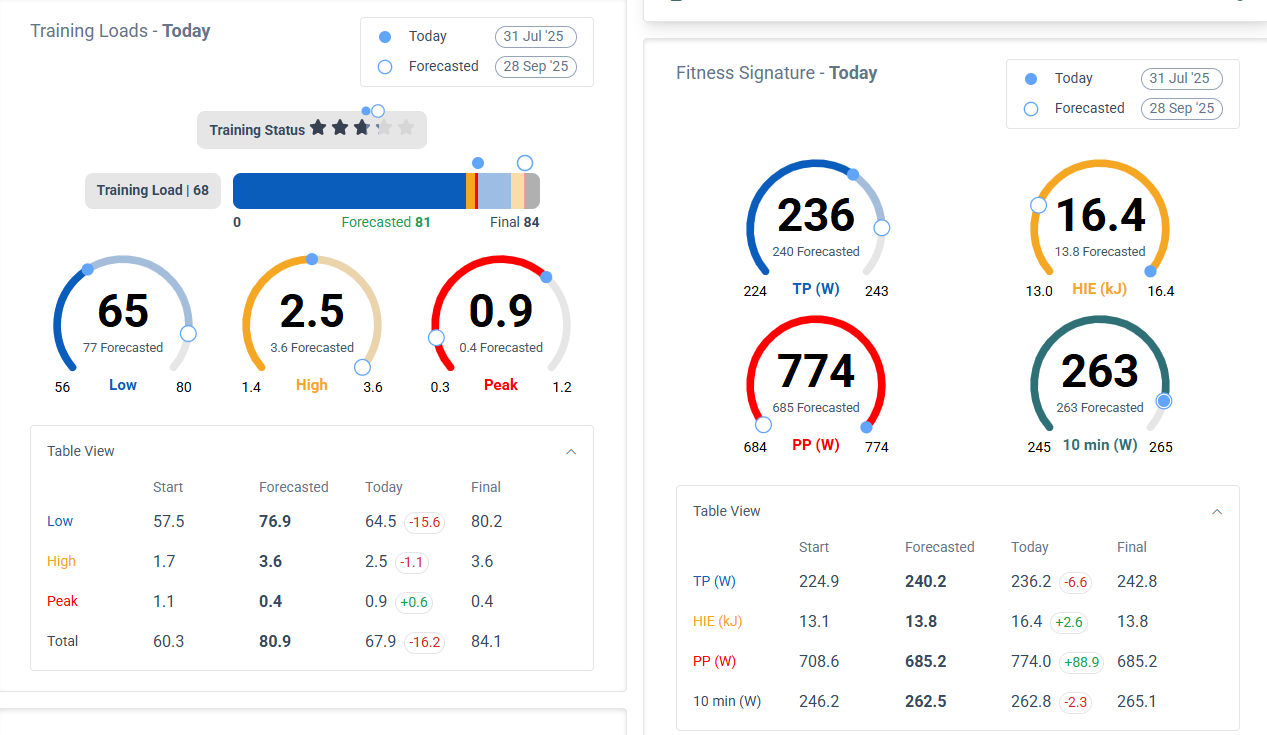

Updating Goal training plan because the forecasted goal is almost complete two months early

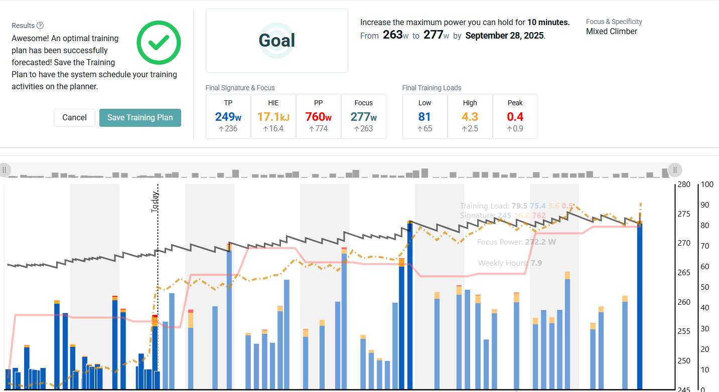

My AI Goal plan to increase 10 minute power by Sep 28 is almost complete. I started July 12. See above.

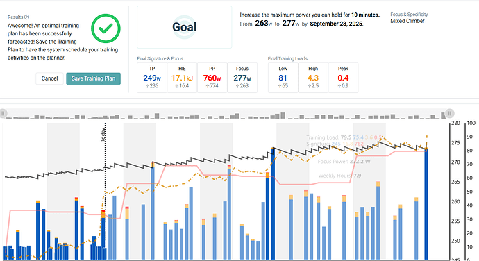

When I go to change program I can update the existing plan with a higher watts goal, but it’s doesn’t add much training load. This is the highest watts it allows while still saying it’s achievable. See below.
Just curious for some opinions if I am adjusting the plan correctly before I hit save?
My guess is XERT wants to respect the ramp rate based off previous training data to prevent burnout. Which might also explain why the weekly training hours don’t increase much either. I have every day available to train for a total of 14hrs per week, and I have set the plan to max out at 12 hours per week, but XERT is prescribing 8-9hr training weeks with one 10hr week before Sep 28. All other settings like recovery are set to the defaults.
I’ve found XFAI goal projections are conservative (a good thing) and it’s not unusual to reach a goal prior to target date.
One thing I’d try is updating the goal past the green text (achievable) into yellow or even red then run the forecast and see what it comes up with. Sometimes that results in an agreeable plan, especially if you are flexible with your hours and have room to add more.
