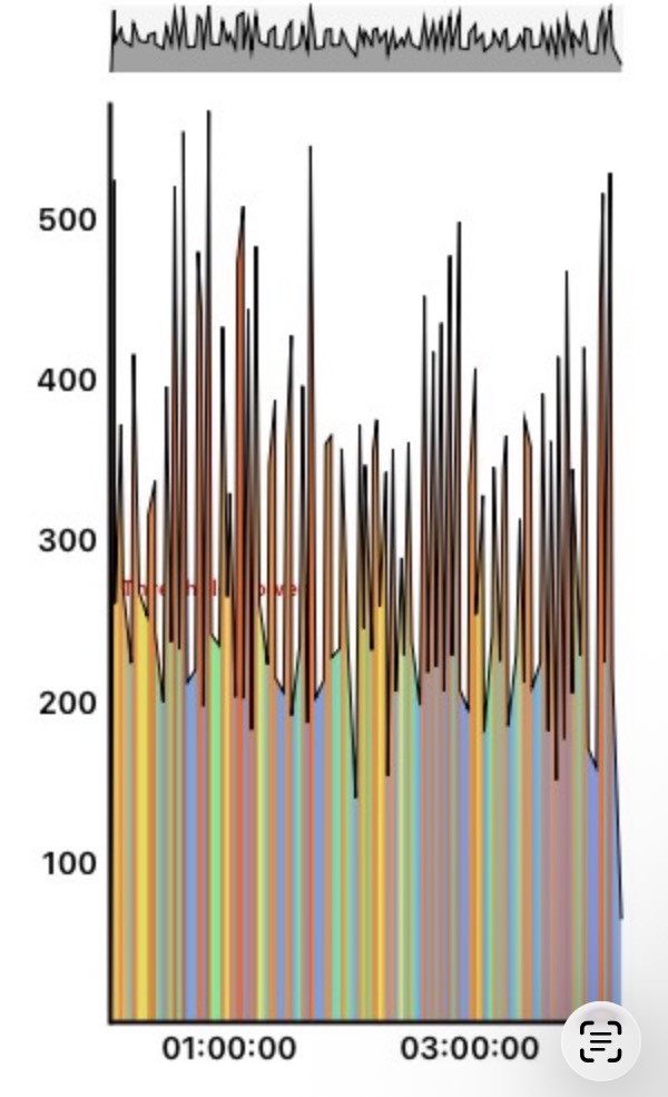

Here is the data from my UCI Gravel Race. Happy to share other data such as power profile if you want to see it.

Hi, chart attached. Lots of short sharp efforts so my TT / 20 minute Focus isn’t exactly ideal for this type of race but works for my TTs. I guess it’s harder to train for completely different disciplines🤔
That looks like a lot of short efforts. I didn’t think the profile would be like that.
I will choose a shorter intensity as my athlete profile. To me, it seems like it’s best to work on HIE energy for those kind of races.
I can see how TTs and gravel races don’t need the same training methodology :sweat_smile:
Indeed, if I was you I would follow what @ManofSteele recommended👍
Yep - each of those short, spikey bits are putting strain on your HIE & PP systems. If you train only FTP, you’d be neglecting your preparation for those harder punches.
