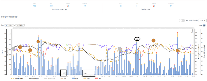

Post your XPMC set to YTD,
What Focus Power and Improvement Rate did you set for your Base-Build-Peak plan?
What is your current status stars count?

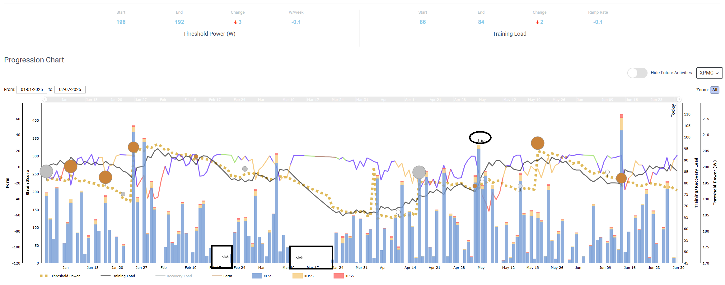

Screenshot 2025-07-01 085922
Primarily indoors, but now I am doing more weekend rides outdoors.
Also do approx 1 gym session a week (with est. xss) but this is a small amount of my xss
Marked when I was sick, and also when we went on a cycling trip
Progression is set to Moderate-1 which is determined as achievable

Changing Decay Method will help reduce the rate of TP decline, but TL has much to do with what’s happening on your XPMC.
While your training is consistent week after week, the load rises and falls.
That’s to be expected if your schedule restricts you from a continuous ramp up.

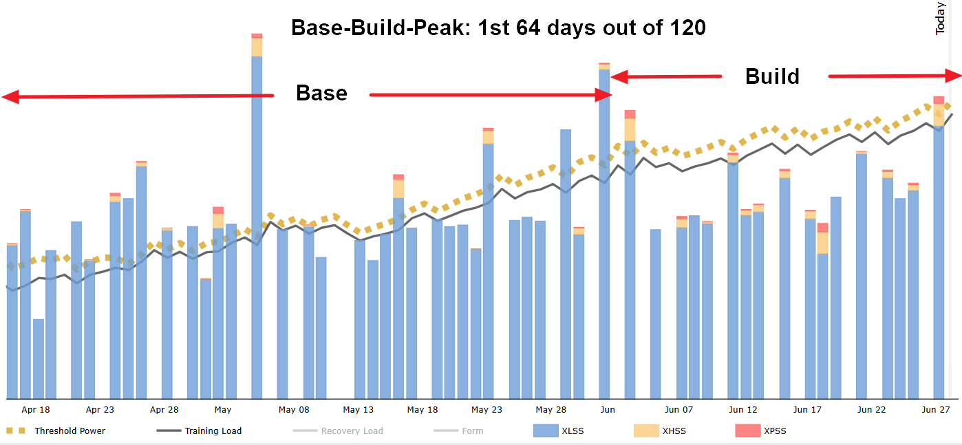

For example, here’s my current Base-Build-Peak program at Moderate-1 ramp rate.
Being retired I have the luxury of no constraints on availability or a weekly schedule to maintain.
I can continue to ramp up to 5 stars status if I wanted to.
Main point is my TP is rising by the progressive TL ramp alone, not BTs which I won’t try for until later in Build or Peak.

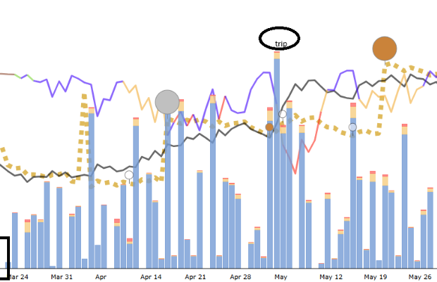

You have a productive ramp too between Mar 24 and May 26 then TL drops off.
jahewMar24-May26
