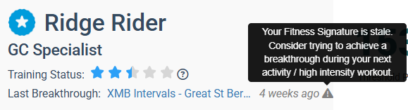

Your last Breakthrough (TP) is indicated on the Training page. If considered “stale” you’ll see a warning icon (!) like this –

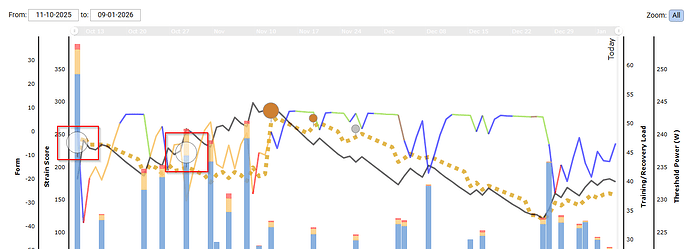

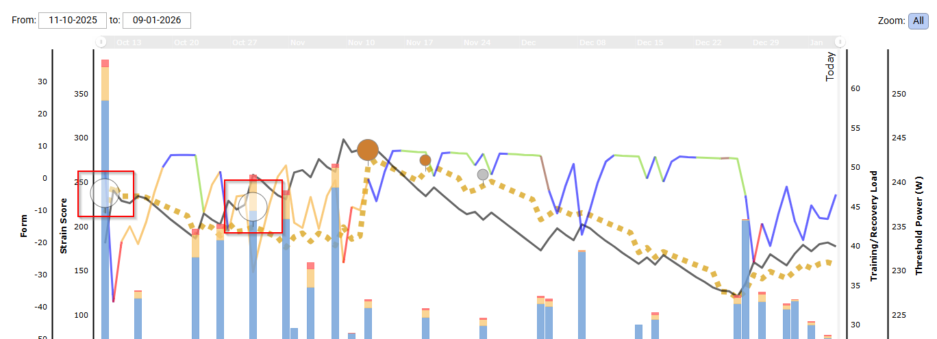

My recent activity was this one. When I go into my progression and change it to 3 months I have 3 BT dots. Two Bronze and one silver. There are also two clear dots, not sure what these are.
I shall give that thread a read and digest, thanks!
Those are “Near Breakthroughs” - where you almost reached your limits, but you stopped just a little short. We have a video coming soon that will be very relevant :slight_smile:
