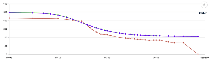

How does your updated signature PP/HIE compare to this chart?
