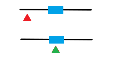

I think a simple line gauge above current power on EBC would also work fine. Something like this –
At a glance you’ll know if you’re below or above your preferred cadence at torque.
Only if you rotate your graphics 90 degrees! :laughing:
