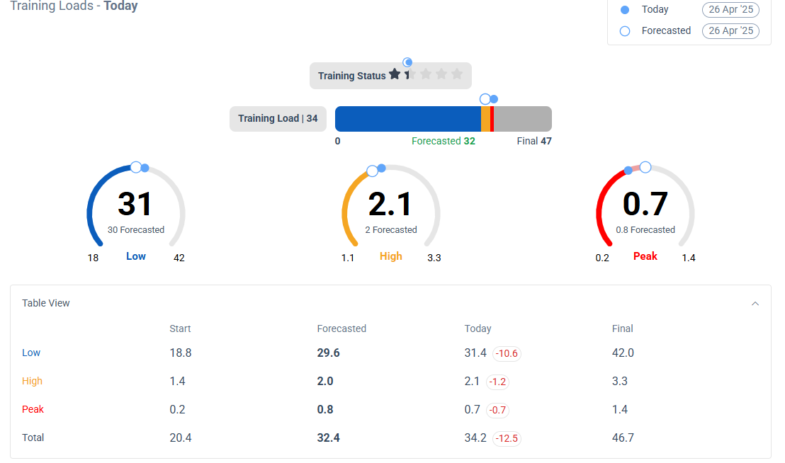

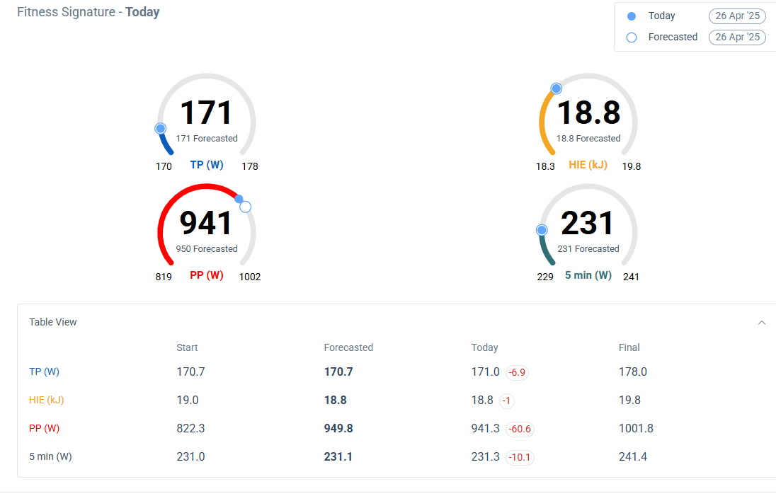

Check out the ‘PROGRAM’ tab on the web - it will show how your training loads (low, high, & peak) and your fitness signature (TP, HIE, PP) are tracking versus the Forecasted values
Fitness Signature
TP 171 vs 171 Forecasted
HIE 18.8 vs 18.8 Forecasted
PP 941 vs 950 Forecasted
5min 231 231 Forecasted

Under Program tab select Table View to see your Fitness Signature and Training Load deltas.
There needs to be an increase in one or more values between Start and Final to establish a progression.
If not, select Modify Plan to ensure that. Namely a rise in Low, High, and/or Peak XSS.
To view your progression at any time, select Progression tab, XPMC, set to 3 months or a Year.

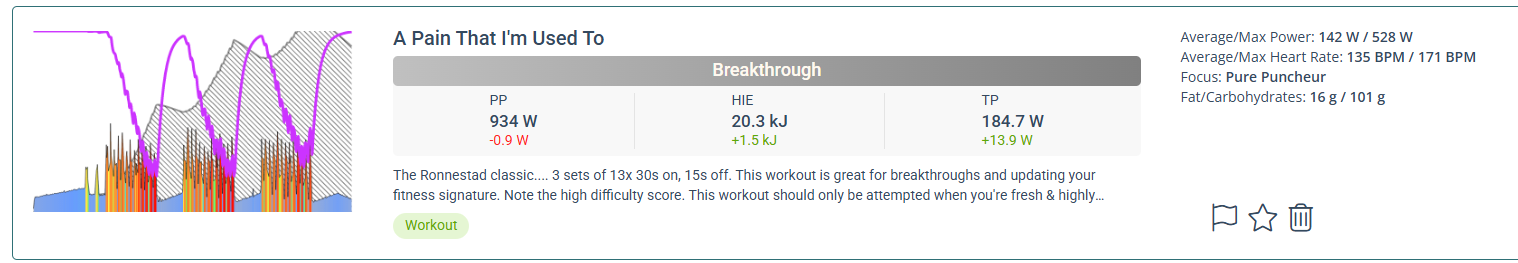

When was your last BT?
If you aren’t confident your signature reflects your current fitness how about riding this workout tomorrow instead of Body Movin?
You don’t have to complete all three sets. Just do the best you can.
You’ll likely get a BT on one set or another.
Done, Thanks for the recommendation
