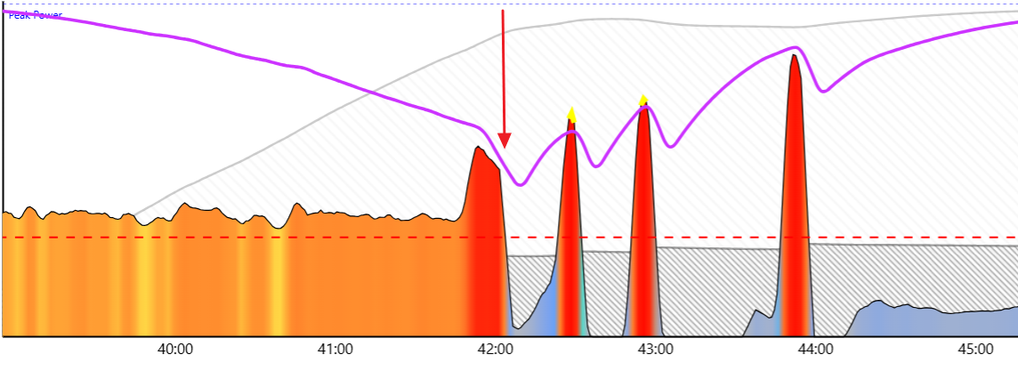

I got a gold BT today https://www.xertonline.com/activities/4xfsfhwz0eqr8umz?forUser=jjamesv and it’s satisfying for my ego, but does it look right?
I feel like I have a memory of sprints on a low MPA can somewhat distort the reading of a sig, but maybe that’s been addressed. The 368w that I did for 4 minutes is 125% of the new 295w TP, so that seems not far off.

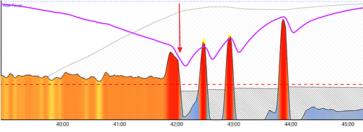

Looks like a hill charge. :grimacing:
Was that a natural failure point at the end of the charge or did you stop pedaling as it leveled out then added the three sprint surges for kicks?
You can always flag it if you don’t like the gold bumps. :slight_smile:
Yep, definitely a hill charge. The first bump is a natural failure, and the 3 following are ‘sort ofs’, in that I didn’t really have anything more, but I also saw the MPA hit, so who knows.
I was in the purple before the first surge for probably 20-30 seconds. Looking at it now, I’m happy to leave it. If I tweak the sig parameters, it doesn’t change much if I’m still allowing for the first surge. Also, I wouldn’t be sure which parameter to reduce anyway.
