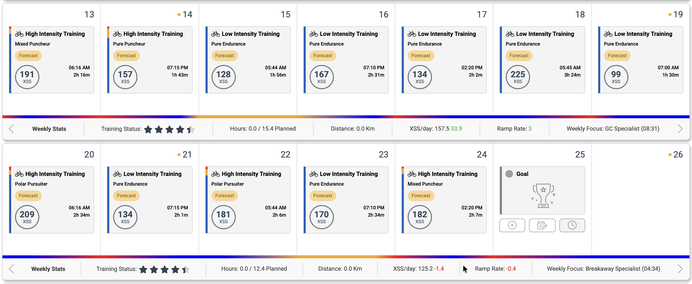

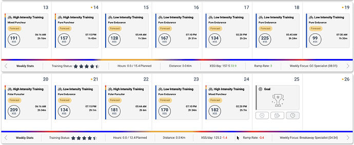

Here’s an example of the final couple weeks of my current program (XFAI Goal focused on improving my 5 min power). Notice that the specificity (mixed/pure) and focus of the high intensity trainings does vary a bit:
FWIW, I use a 3:1 polarization ratio. But I’m finding that as my High TL increases that I’m often doing back to back high intensity days on occasion, which is needed to maintain progressive overload. I’d rather have back to back days of ~12-15 High XSS rather than 1 day of like 30+ High XSS. Your experience might vary.
