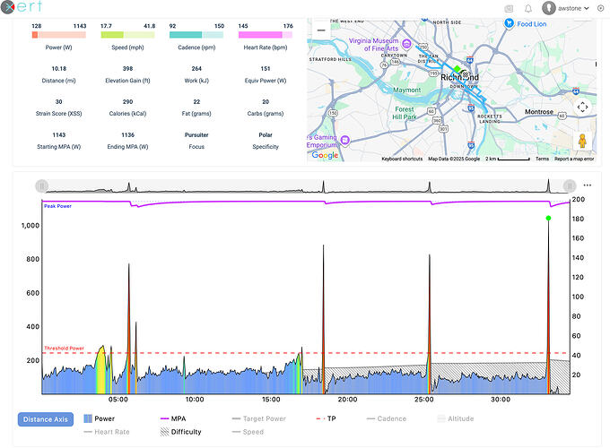

FWIW, what I usually do when this happens on a very short sprint (and no other hard efforts) is rather than flagging the activity, you can scroll below the MPA chart and click the ‘Previous’ button to see the MPA chart recalculated with the starting signature for that day. I then manually key in the max power for the activity as the ‘Peak Power’ for the activity and then ‘Save’ the changes. This should allow your Peak Power to increase in response to the max effort sprint, but should keep your Threshold Power unchanged.

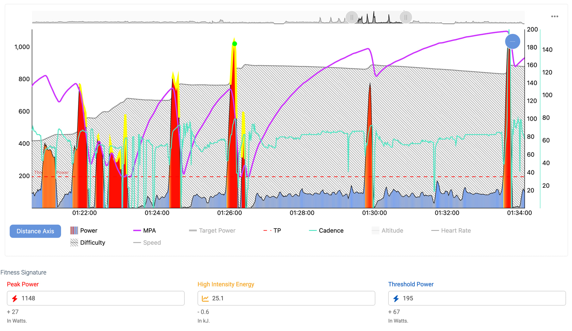

I have a similar issue. My TP is really bad but I can sprint - the last view breakthroughs with sprints pushed LTP and TP to unrealistically high values. E.g. yesterday I did an easy ride and with a few sprints to fill my magic buckets. And then a few sprints more because MPA was already way down => TP 195 → 262, LTP 132 → 201. The old values were 10-20 W too low but the new ones are definitely wrong.
When I correct my max power to 1230 W (I can’t reach that indoors because my Taxc Neo 2T slips somewhere around 1170 W) and extract again, I get somewhat more sensible TP values but PP and HIE look too high: PP 1312, HIE 32.7, TP 221 in this case.
