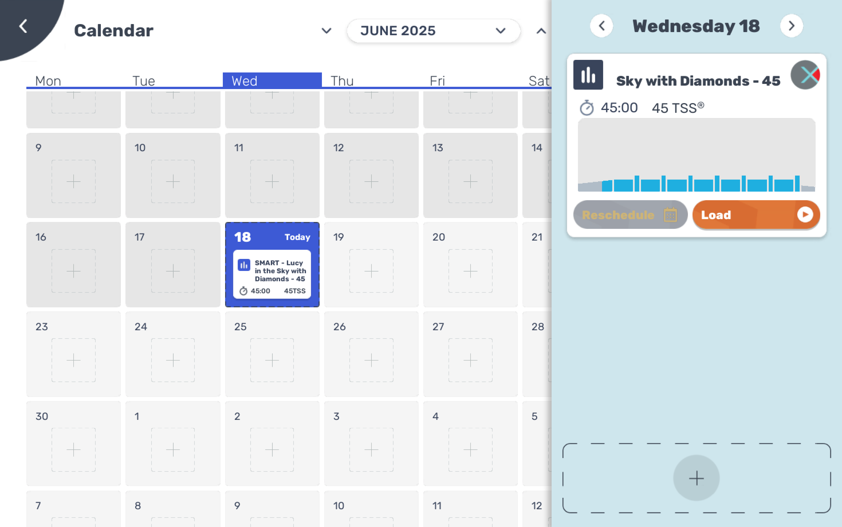

I scheduled a Lucy in the Sky with Diamonds workout as a test, and it appeared in the Calendar & Planning section — not under the standard Workouts menu. So be sure to check there for your synced workouts!

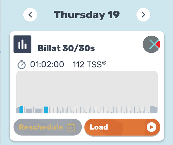

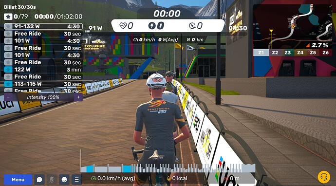

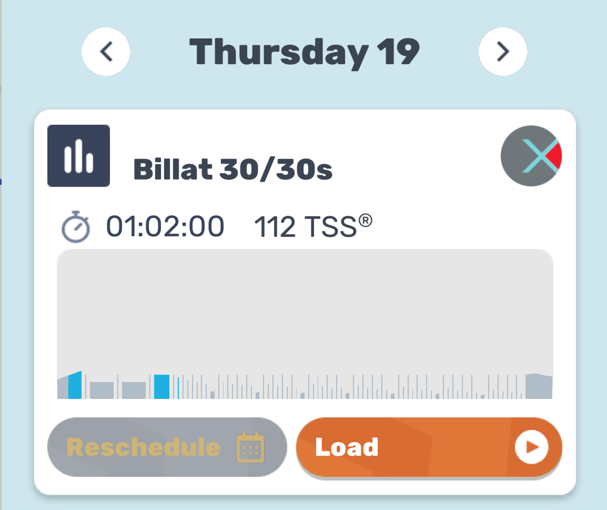

Hey Scott, I gave this a try but it seemed like either Xert or MyWhoosh is doing something wrong. Connecting accounts was easy, the workout appeared once I opened the app and went to the calendar. The interval targets though were completely off. I have chosen Billar 30/30s with an FTP of 203. In MyWhoosh I have set the same FTP. The intervals for this workout should be around 264/275 W but appear to be way too low. If you look at the workout in calendar (screenshot attached) and the workout screen itself the targets are wrong. Do you know what the issue might be?
BTW, just realised that it seems to be wrong in Rouvy as well. In Rouvy it always worked fine so far.
It seems like this workout is special as it doesn’t work on both platforms when transferred. I tried now other workouts (e.g. Tabatas by Scott Steele) and this workout among others was successfully transferred with the correct interval targets to both MyWhoosh and Rouvy. What is different with Billat 30/30s?
I don’t see those workouts in the Standard workouts folder so they must be shared workouts from a community group you joined (Club or Coach).
If you view details and note differences in how the intervals were defined that should explain why one works and the other doesn’t. You can then open the Billat workout in Designer, Copy it, change the definitions to match, edit Title to whatever you want, and Save.
Some workouts (with #MIXEDMODE tag) are done in SLOPE mode and users can use their gears & cadence to try and hit the power target. These intervals are often exported as ‘free ride’ segments to other apps since they don’t support mixed mode workouts.
HTH!
