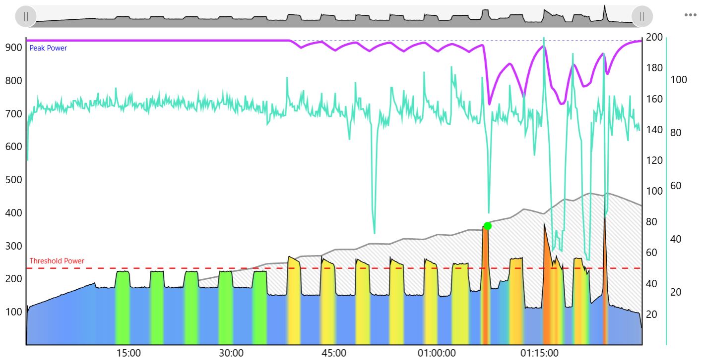

Good idea about the chart! Here it is, and I’m also enabling cadence to make it easier to see my problem:
As you can see from the intervals towards the end, my cadence basically tanked (ignore the first cadence drop, my phone fell off). The only reason why it’s not zero is because I then went out of saddle and doing 30rpm just to get some power out. It was under the target, but still, I thought better than giving up completely.
Lowering TP is not to make things easier, but for allowing you to generate realistic breakthroughs to dial in you Fitness Signature.
Also: easy rides should be exactly that: easy! So you have enough energy to do the hard rides really hard. Just like you did with this one! The MPA-curve looks almost like it should look and you even finished it. I would say everything done right here :smiley:
