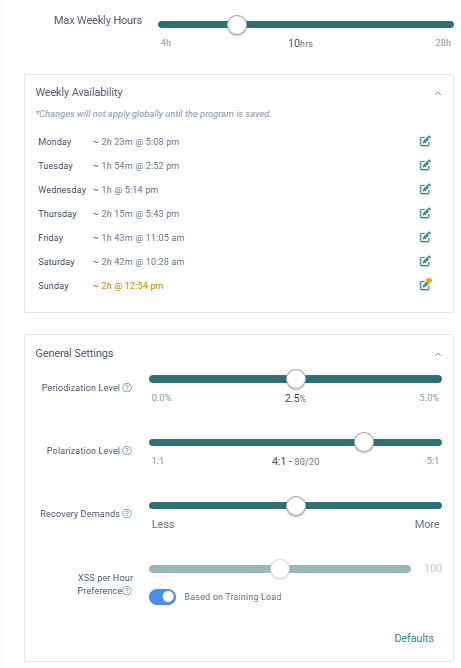

Post a desktop-view screenshot of your current and upcoming week on the Planner.

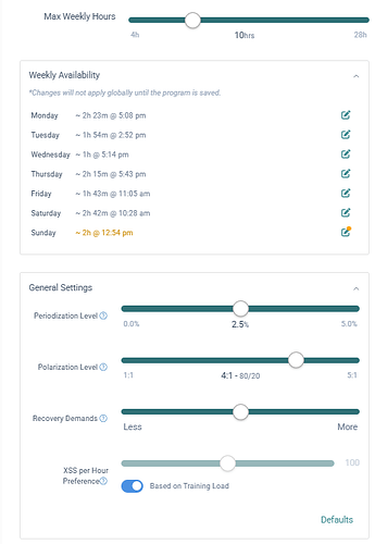

@ridgerider2 I have the same confusion, here are my Screenshots.

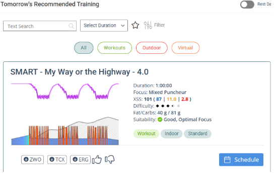

Tomorrows Schedule is 2h 14m, thats a lot volume for 95 XSS of a high intensity Training
My XFAI Type is : Polar Breakaway Specialist
As you can see, the recommended training is only 60 minutes. Will that negatively affect my weekly volume? What about the “missing 1h 14m”? Is that just not needed?
please excuse, i can only add 1 image per post
this is the setup.
