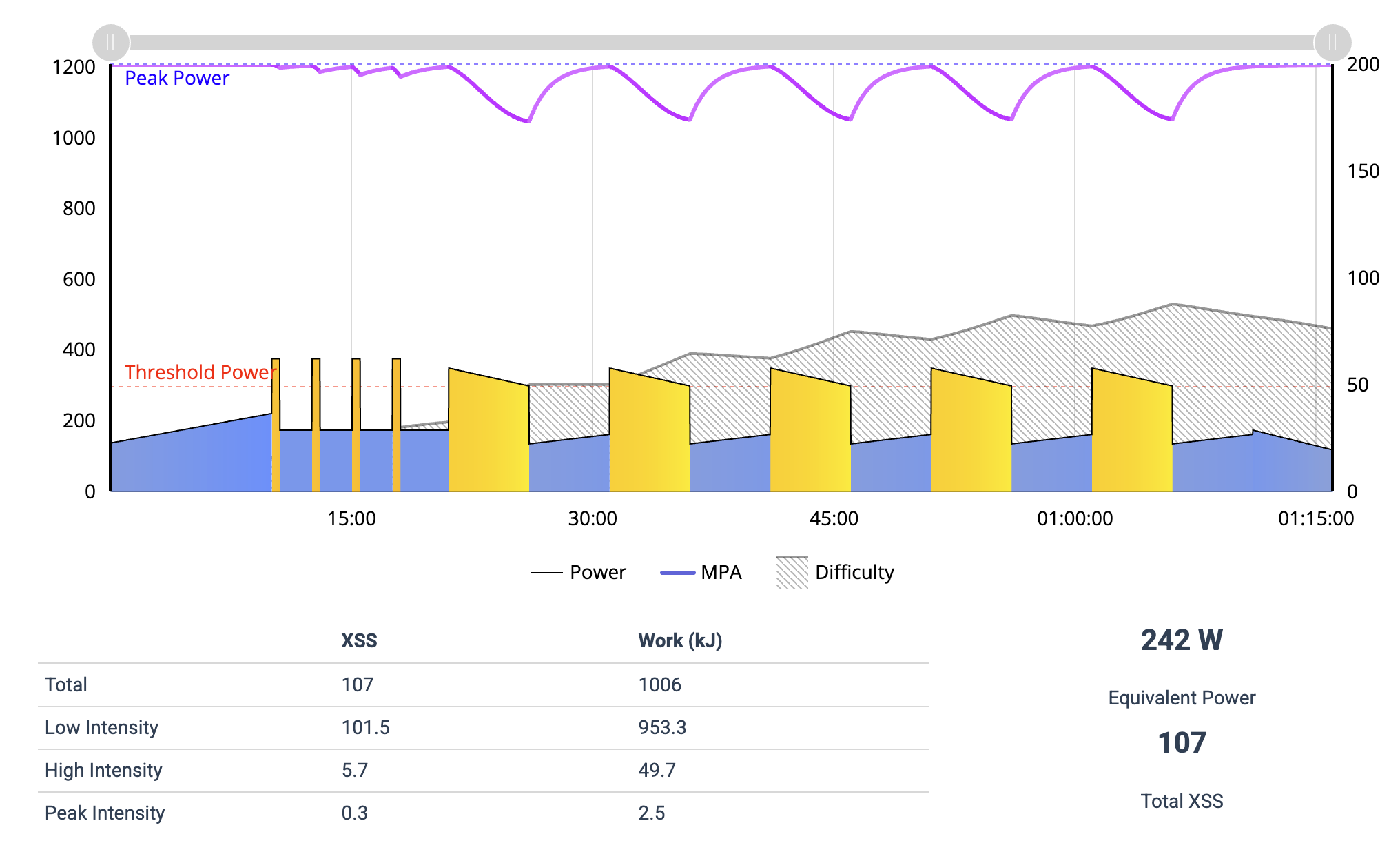

We’ve made some key changes and improvements to how our SMART workouts get converted into regular workouts that you perform on other systems. Workouts with variable power intervals (XSSR intervals for those that are familiar with unique Xert feature) get better converted now making them easier to complete on other system when imported. For example. SMART - Closer 150 looks like this on Xert:

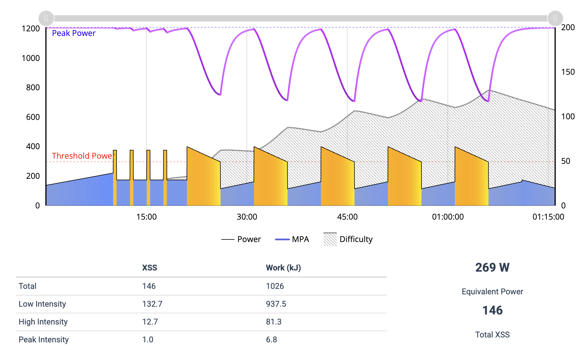

When imported to other systems, it would looks like this previously:

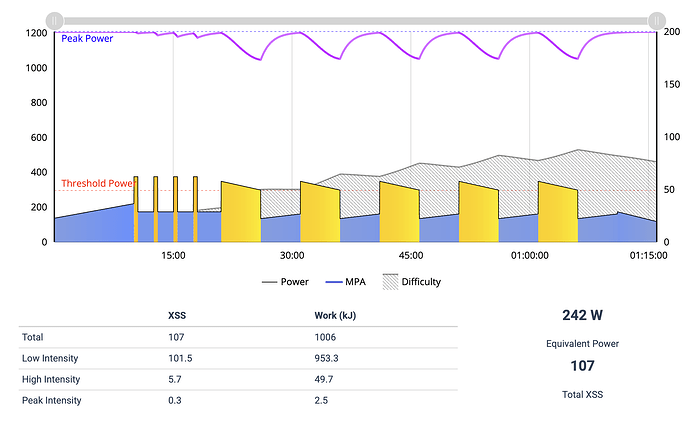

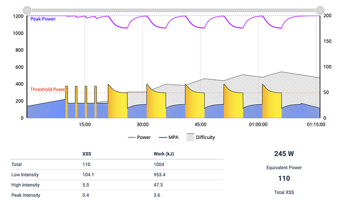

With the new changes, it now gets simplified to this:
Note how the previous conversion used the same start and end power values which ended up making the workout harder and with more XSS overall. With the new conversion method, the start and end power targets change to allow the XSS values line up more closely with the existing workout on Xert making the workout easier to do and better for your training.

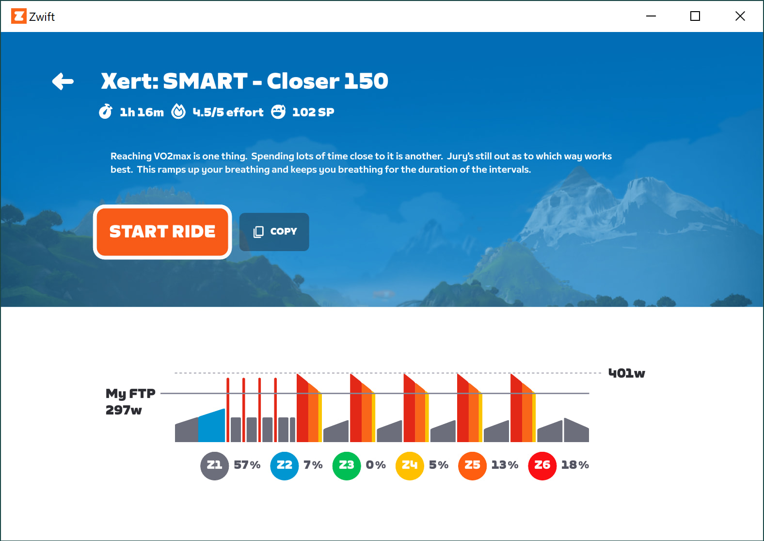

FYI, if you have the workout already loaded on Zwift, you may need to remove it first before Zwift updates the definition. Use the Zwift Sync page to Unschedule it first and the send it again. Cheers.
Here are before-and-after workouts as shown on Zwift for Smart - Closer 150:
