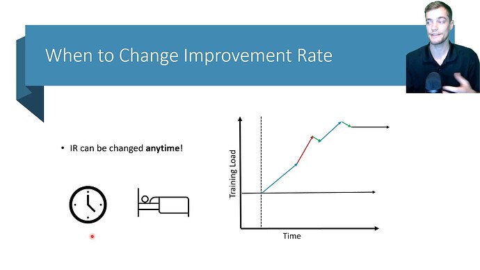

Try changing IR to Slow and see if the Unachievable notice clears.
When Improvement Rate is >0 XATA will always tell you to ride more over time.
The higher the IR value the faster the rate of TL increase.
Eventually what goes up must come down. :slight_smile:
Changing improvement rate with XATA –
Back up to review more content.
When you reach max hours and want to level off, switch to Taper, purposely scale back to hours you’re comfortable with, then change to Maintenance.
At that point you can continue to improve by varying Focus Duration (FD) stimulus and ride blocks for X weeks at a time.
E.g. if you’ve been targeting GC Specialist (8-minute power), you might change to Puncheur (4-minute power) for 2-3 weeks. Then take a breather (rest week set to Off-Season) and change FD again.
During a Maintenance phase you can also deliberately pick the hardest workout amongst recommended workouts on HIT days. Or strive to higher Challenge Levels when using Magic Buckets. I.e. same FD target but you are condensing the time required to fill the buckets. That raises the Difficulty Score.
