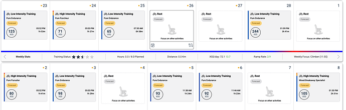

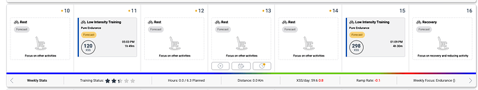

My next planned event is in mid-June next year. I generated an XFAI plan with that event date, but the schedule in the Planner looks a bit strange. At the beginning of the plan, I have only two workouts per week, including one that’s 4–5 hours long. Later in the plan, it starts to look more structured, with the training volume spread over multiple shorter sessions throughout the week. The early phase just seems odd to me…

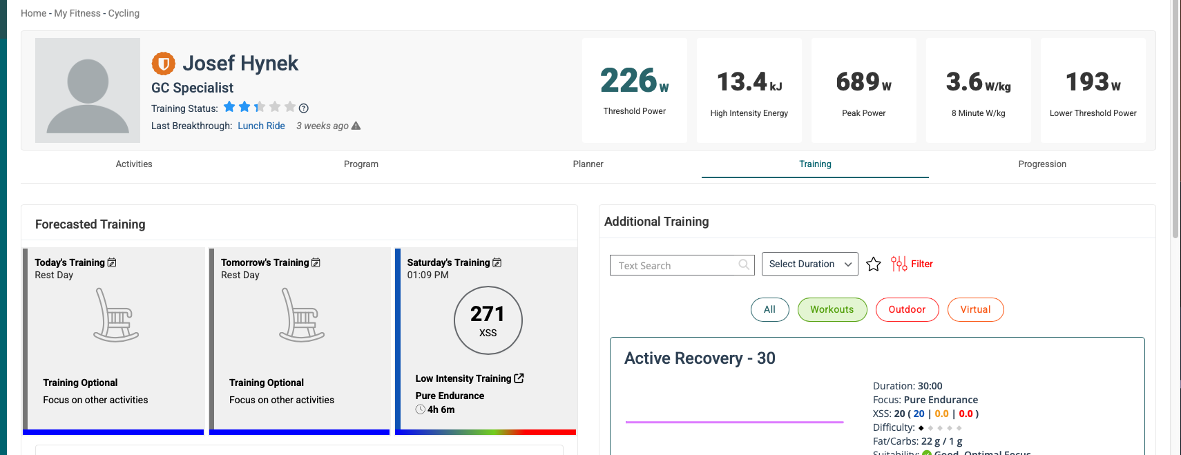

I’ve attached screenshots showing my current training status and an example week from the XFAI planner (next week and example of march week).
