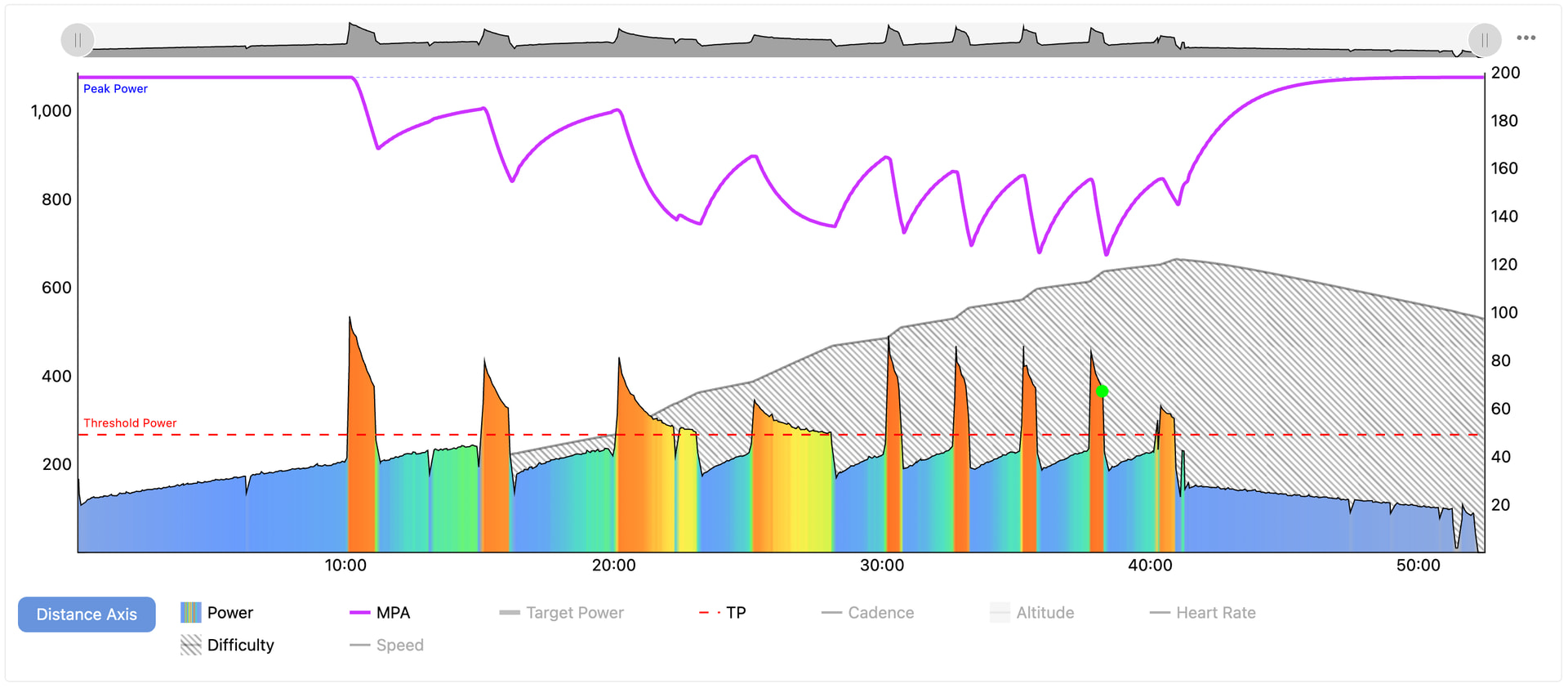

I did hardness test 11 today because it appeared in my planner as my recommended training.
I was supposed to to it yesterday but was travelling and i last rode 3 days ago in a ZRL Zwift Race.
The session was super tough, I had to stop pedalling on almost every interval. I don’t remember struggling so much on a Hardness Test before although from what I can see in Strava the highest I have previously done was Level 6
Here is a link to the public session, Xert - Activity | Hardness Test - Level 11 - Xert
Is it expected to be that tough?

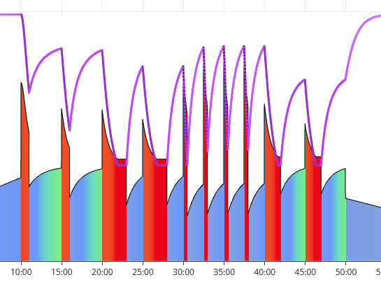

Level 11 is TOUGH! I almost made it through Level 11 (alternate) last year… I cracked on the last couple of longer, sweeping intervals:
