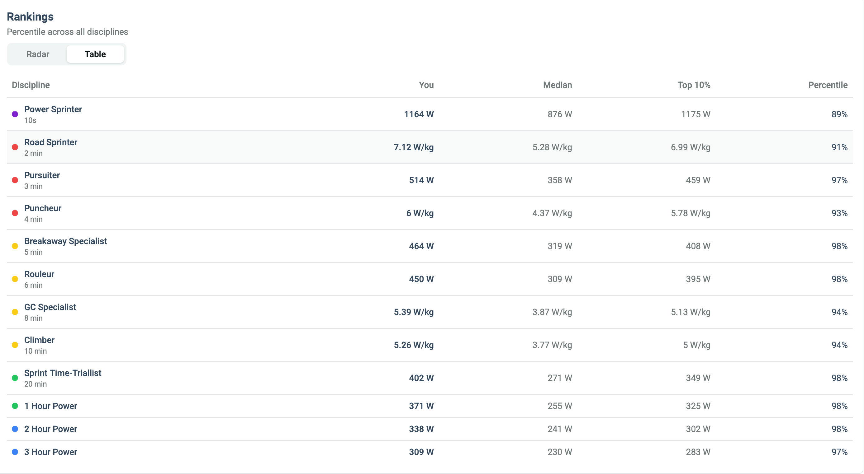

I am looking to train in becoming a better hill climber and time triallist. I am wanting to make the move into TT’s next year as my main form of competition as I prefer steady state efforts and tend to get walloped in bunch sprints in crit and road races.
I have been using Xert since February 2025, initially focussing on 5 minute power from February 2025 until November 2025. From November 2025 until April 2026 I was focussing on 8 minute power as per the XFAI - Event. April 2026 until September I was then focussing on 10 minute power as per the XFAI - Event.

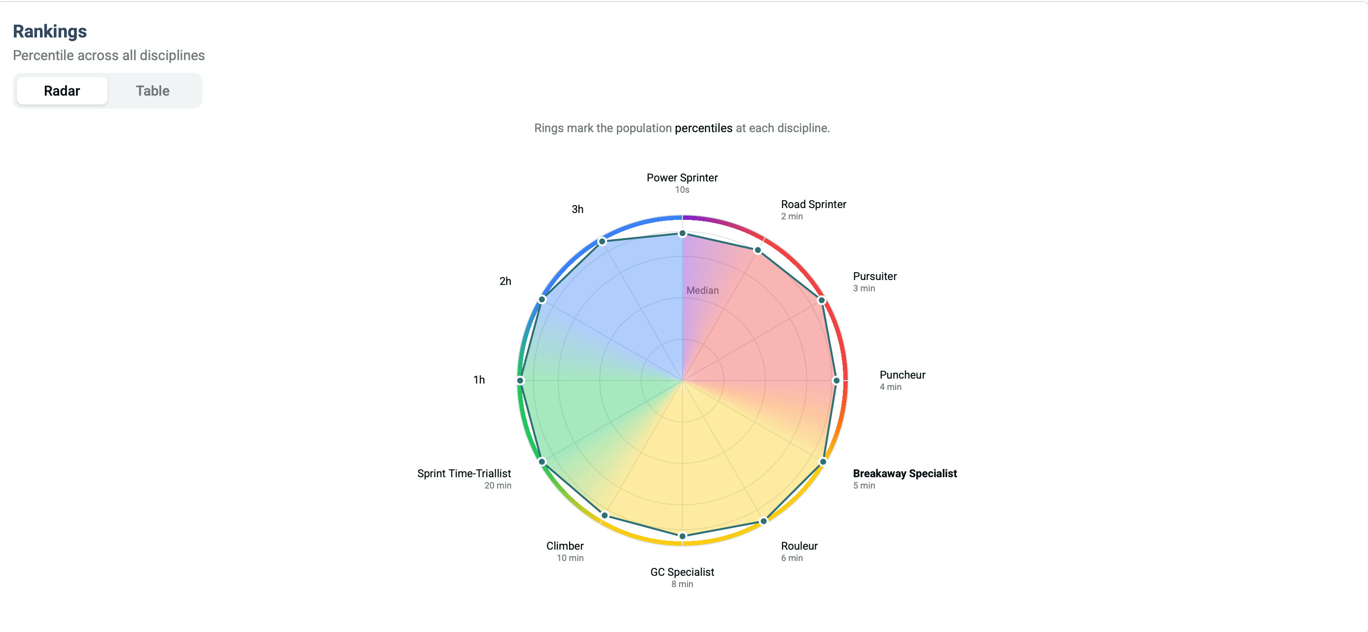

My Xert spider chart is fairly uniform and I am struggling to workout where I could turn my attention to get the best results for hill climbing, time trialling, and small achievements like a sub 40 minute Alpe du Zwift. I find being an all-rounder means that I have too much choice in terms of focus duration and scouring the xert forum and glossary/blog does not help me much.
I am torn between working on 10 or 20 minute power for my goals. Any help and insight would be greatly appreciated.

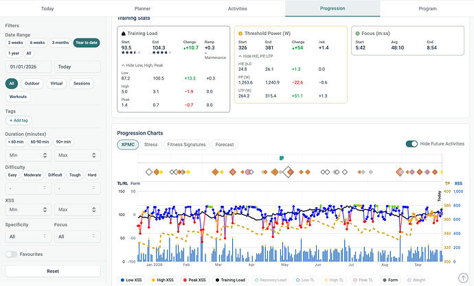

I have set up a goal plan with a pure sprint time-triallist specificity. I have selected Alpe du Zwift as my main climb goal (Sub 40 minutes). My current time set this week is 42:38 and when I analyse the effort Xert determines the climb as a sprint time-triallist specificity.
Looks like a really good plan with TP making up the majority of improvement you need. A Pure Sprint Time-Triallist (or could also go with a Pure Climber) is an excellent choice. Your TP gets a 13W increase and your HIE gets a 1.1kJ increase with PP staying stable. That’s what should happen when you chose that Goal. Your training will involve increasingly more low and high intensity XSS as the plan progress making your TP and HIE stronger every week. This is key to maximizing your fitness for these longer hill climbs. You can see how TP and HIE will increase (click on Low or High on the chart) and PP will stay flat (click on Peak). For reference, you’ll add 13W to your 20 minute power from the TP increase and less than 1W from the HIE increase over 20 minute effort, hence why your focus ends up being mostly TP in the end.

Reading through, it sounds like you’ve got two different goals sitting under one question. The hill climb races (2-10 min, all out) are one thing, and the Alpe sub-40 and TTs are another. Alpe is a 40-minute grind, and you’re at 42:38, so you’re about 6% off. I’d guess that gap is more about sustainable power than short power.
You also said every Zwift hill climb race gave you a breakthrough. To me that says your short stuff is already responding well and probably is not the bottleneck. After months of 5, 8 and 10 min focus, I’d say the weak link is further out, and that’s where I’d put my attention for TTs and the Alpe.
So I’d lean 20 min for the next block. It’s closer to what you’re aiming at, and a higher 20 usually lifts the 10 along with it. Then if you want to race hill climbs again, a short specificity block with maximal 3-8 min efforts a few weeks before should sharpen you back up, since that power doesn’t vanish quickly.
