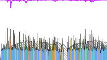

Edit: best I can do if share a 5 hour ride I did recently

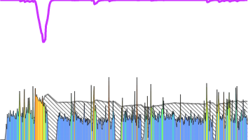

I tried on Monday to do a 10 minute effort, I had done a number of really easy days so my status was very fresh. I was really struggling after a couple minutes as my legs were burning managed to get to about 5 minutes then a plug popped out of my rear tyre so had to stop but I wouldn’t have made 10 minutes anyway.

I see most of your ride were at 100-150 W or so. Your heart rate at 140 bpm, while the highest was 176 bpm. Not sure what your actual max HR is, but this can be hard enough if 176 bpm is near your max HR. And then you had a few sprints spread through the ride.
Have you tried finding a long hill and going all out? Ideally at least 10 minutes long at max speed, but a shorter might also work.
It looks like all your sprints are too short and too much spread out to trigger a breakthrough.
It could also be that you have the power to ride faster, but the narrow and winding roads might make it hard to safely ride any faster.
Generally if I do a long ride at around zone 2/zone 3 power my heart rate will start off hovering between 120-140 then as the ride goes on it gradually raises to over 150, my max on this breakthrough attempt the other day was 192
I tried to hold around 200 watts for 10 minutes on monday and my legs were not having it at all even though I was “very fresh”, I got a flat after a few minutes and had to stop during the effort but wouldn’t have got to 10 minutes anyway. Its my legs preventing me going harder I need to find out why they are chronically fatigued even after a string of easy days.

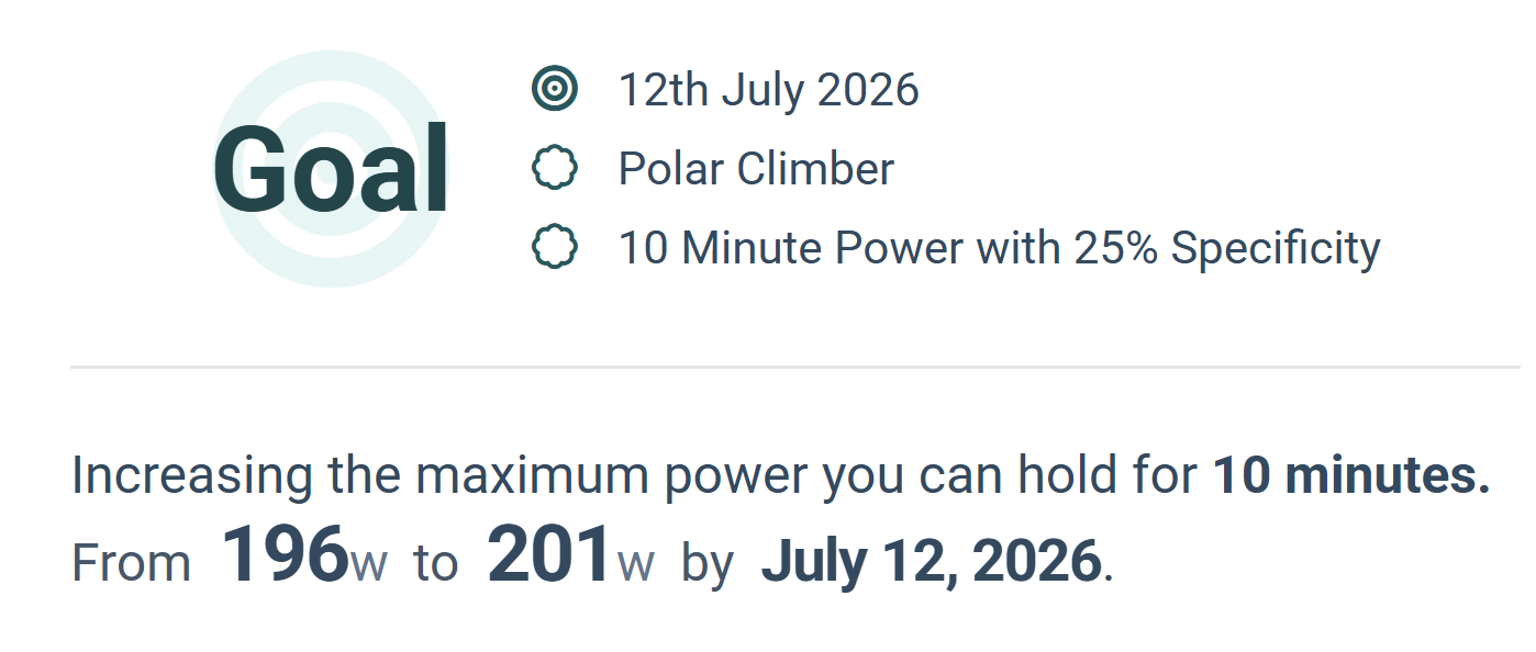

I looked at the ride data you posted, and aside from the breakthrough attempt and a couple intervals, most of the riding shown is ~50% threshold power, with very few MPA drawdowns which puts it in the low intensity / cardio category. That should be around your lower threshold power, AKA your long-slow-distance power that you can sustain all day. I don’t know if these are representative of typical training rides, but I think if you want to be increasing your threshold power more, you need to be doing more like 80% TP with some intervals at or above TP. If TP increase is your goal, then maybe you should try one of the goal-oriented programs: e.g.
Maybe a more defined workout plan with some shorter iterations and metric-based goals will help you mentally feel like you are progressing more.
I’m a similar age, weight, and fitness as you, and also prefer a more structured schedule of training. I understand the importance of maintaining the schedule for fear of skipping a day leading to a cascade of falling off the cliff. I do however wonder if you are getting enough rest and recovery or have overtrained, and are getting enough fuel during longer rides as was mentioned before. You don’t have to skip a day riding, but make sure your “rest” day really is an easy ride and don’t push it. Like heart rate zone 1 / lower zone 2. When I toggle the altitude on in your ride data, it kind of looks like you’re bonking partway up climbs. You have a nice spike of TP+ power at the start, and then drop down to ~50% TP for the remainder on a lot of hills. That looks like you’re at your limit and not fresh. Make sure you’re getting enough calories on your multi-hour rides and enough recovery time between big rides or workouts. The power drop-off mid-climb could be for any number of reasons, including something not directly related to training, but maybe something above will help you find an area to improve.

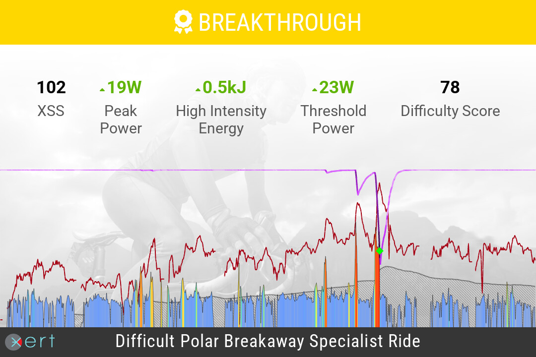

Thought I’d post a bit of an update on this saga

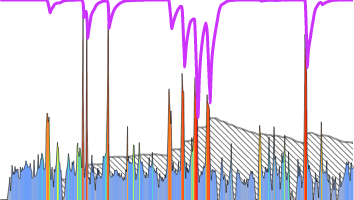

Past few weeks I’ve had some issues with my ribs so haven’t done anything more than easy rides no efforts, the bike had its new groupset fitted yesterday and I’m feeling a bit better so today towards the end of my ride I thought sod it I’m gunna have another go at a breakthrough.
I think this is the first gold breakthrough I have ever gotten! I could have gone a bit more as well I think.
I feel a bit more positive about the whole thing now, I think I’m going to dig in and get back on the program on Monday. I’m at 198 TP now… 250 here I come!
