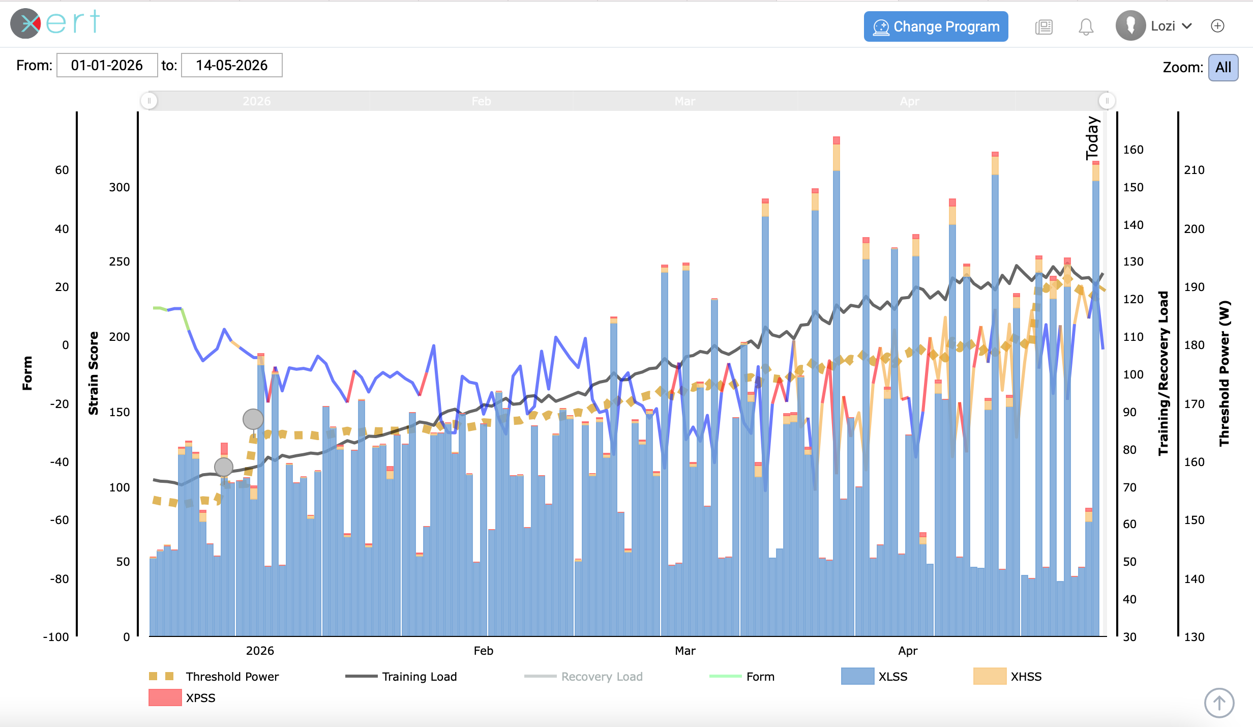

I have used XERT since about September last year, this year I chose base build peak in January 1st and it ended a couple days ago.
I was struggling to keep up with the weekly XSS it seemed to give me the same thing everyday unless I had gone way overboard on the intensity the day before and even then it never gave me rest days it was a relentless grind trying to keep up.
once it ended I thought going on a continuous program I might get a bit more easy days but even set to slow it wants me to do 16 hours a week, I did my second longest ride ever time wise yesterday at 5 hours with some intensity and today I’m on a 214xss deficit. It’s set to slow I can’t see how this level of demand is only slow progress.
My FTP number it gives me is only 190 after all the hours and effort I’ve put in it’s feeling a bit futile at this point. I’ve seen newcomers saying they are 200 watts FTP as a beginner I’ve done 311 hours so far this year and I’m not even at what a lot of people seem to start out at. Cycling can be quite elitist and maybe people will say my 16 hours a week are rookie numbers but none of the cyclists I know have ever done a 10 hour week let alone consistent 16 hours a week but yet they are probably faster than me.
I dunno what to do I feel pretty crap about it.
Hi @Lozi ! First off, I want to acknowledge what you’ve actually done this year. You’ve taken your training load from 71 to 126 since January! That’s roughly +3 TL/week sustained for four months through a Base-Build-Peak cycle. That’s genuinely hard work!
A few thoughts on what you’re seeing:
On the “no rest days” feeling… Xert will always recommend something; that’s by design. The overall volume it asks for is driven by your Improvement Rate (IR), not by whether you rode yesterday. The good news is you can change your IR anytime. Dropping to Maintenance or Taper when you need recovery is exactly how we intend athletes to use it! Sounds like you might benefit from a week (or more) of reduced volume & dedicated recovery.
On the volume itself… you’ve accumulated a lot of training load (~126), and at that level, even “Slow” IR requires a substantial XSS load to keep producing progressive overload, which is the basic mechanism behind fitness gains. The program isn’t being unreasonable; it’s that the cost of continued improvement goes up as you get fitter.. the more you ride, the more you need to keep riding to maintain that fitness.
On the FTP comparison… firstly, I often like to remind myself in cycling that comparison is the thief of joy, especially in the age of “influencers” and social media. There will always be athletes with higher FTP, faster/more aero bike, etc. I think we all sometimes need to be reminded to celebrate our own progress & not be discouraged by comparing our training time, fitness level, etc. to others.
Now, back to your point… Comparing raw FTP between athletes is really difficult. Body size matters a lot (heavier riders tend to have higher absolute FTP regardless of training), and there’s a genetic component to where each of us can ultimately get to. You’ve actually seen meaningful improvement this year, which is great! You should celebrate that! Reaching the upper end of your own potential generally takes years of consistent training, and that journey is part of the fun of training, in my opinion.

If you’re comfortable sharing your XPMC chart, that would help the conversation along.. folks can then help review your data & contribute their thoughts.

Based on your XPMC you likely have a latent BT waiting to be expressed.
Next time you’re feeling especially fresh pick a route that allows you to execute the standard fitness test outdoors.
That’s two ~20 sec sprints (stand and smash the pedals as hard as you can), full recovery between them, followed by a series of escalating intervals above TP until you fail on the last one.
You can alternately use Magic Buckets to execute the escalating intervals by following these instructions.
Let us know how you do.

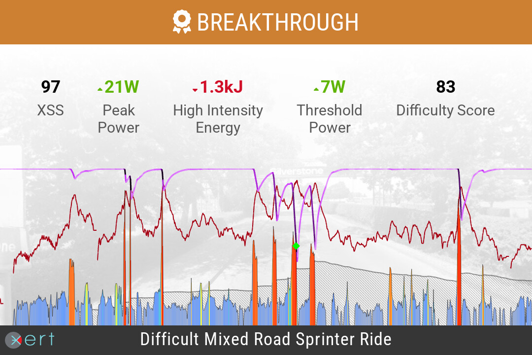

If you acheive a BT go ahead and post the BT report.
BTreportIcon
“latent BT” :white_check_mark:
…just need to ease off the gas after such a long period of sustained fatigue and solid ramp rate. Perhaps look for green or blue status for a number of consecutive days before attempting a BT.

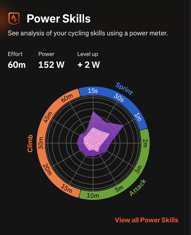

This skills wheel on Strava shows the situation well, the dark purple being the end of last year basically and the lighter colour being now.
The good ol’ spider chart .. something we were the first to show 10 years ago. :smiley:
Interesting to see the comparison as they do with nice colours. Main thing to remember about all other systems is that their charts are based on your mean-maximal power data (MMP), i.e. your best efforts over the period whereas Xert uses what your Fitness Signature suggests you can do. Many never perform all those durations with a fully maximal (well-paced, to failure) so they often underestimate true maximal power. The lighter colour section could just mean you haven’t tried yet. :slight_smile: which by looking at your breakthroughs is apparent.
One other point is to recognize your Signature Decay Method. Using Optimal will have a slight underestimation of your Fitness Signature to provide an opportunity for you to get a breakthrough so what you see as today’s estimate could likely be an underestimate. I’ll be curious to see what you get when you get your next breakthrough. Don’t be surprised if you end up getting more than one. Often athletes will get a breakthrough one day and another a few days later. Depends on athlete and how motivated they are in the end.
Yeah you’re right about the strava chart the dark colour was when I was doing XFAI 3 minute power so I was doing all out sprints a lot and going pretty hard pushing to level 10 quite a bit on XMB, I had a bit of a glute/hamstring issue which is why I knocked it all off and changed to 10 minute power base build peak to aggravate it less which did work but I haven’t done a proper hard effort really this year so far, its been mostly about me trying to keep up with volume.

I gave it a go today.
I tried to do the magic buckets way but I didn’t make level 10 I stopped at about 9.5. It was a struggle to level 8 so it didn’t feel like I was quite with it, I haven’t done anything close to this since December intensity wise.
I fitted a new chain and cassette the other day in preparation and its clear that was a mistake as the chain rings are pretty worn and did not like the new chain, its noisy in the middle ring and the big ring throws the chain off when I get around 300w, Im in the process of upgrading the groupset to something modern so I’m going to have to hurry that along. Not an excuse I still managed to do it in the middle ring just about.
I think I may carry on with 3 or 5 minute power instead of 10 for a few weeks and try again.
