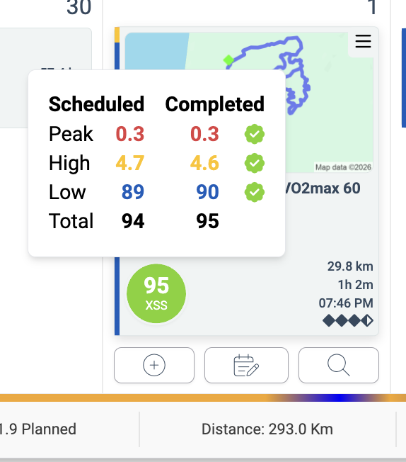

If you have an XFAI plan or if you schedule a workout in your planner, you can click on the circle in the planner to view the Planned/Forecasted vs Completed XSS. The circle is also colour-coded by L/H/P if you met the planned/forecasted XSS:

This circle appears for some of the days and not for the rest. Not sure how and why it doesn’t appear all the time. For the rest of the days it only shows completed XSS without scheduled XSS numbers.
