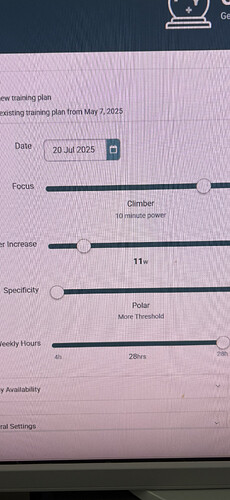

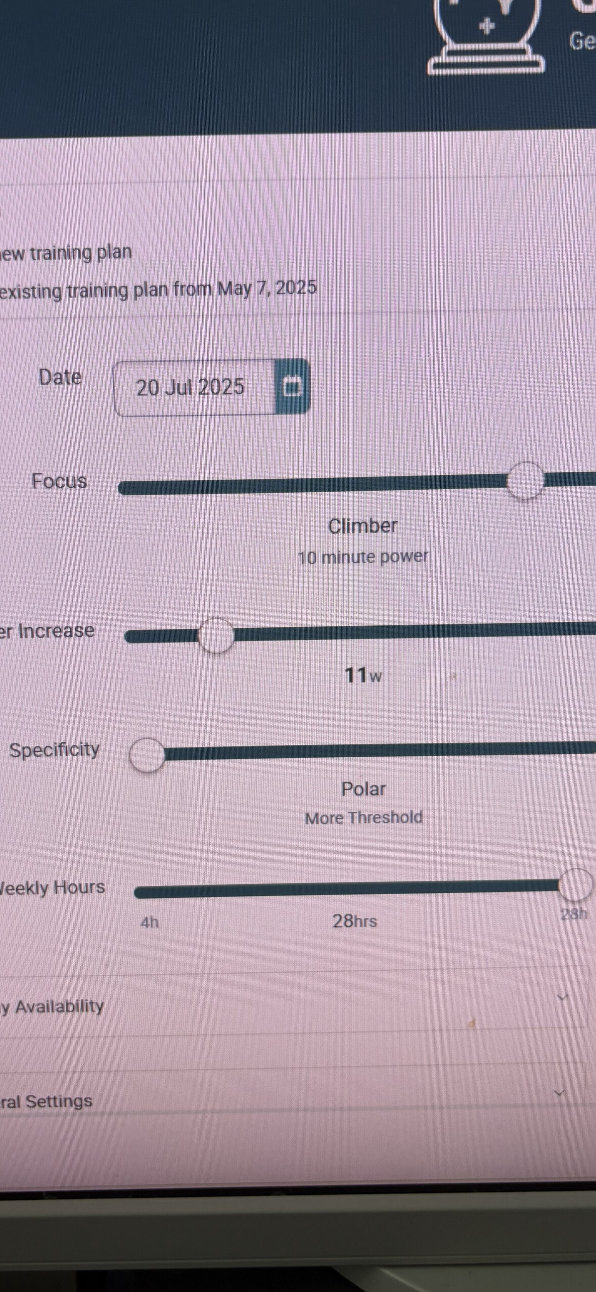

Hi, I will have a similar race on July 20th
, the l’etape du Tour 2025. 130km with 4500 altitude gain.
I just wanted to check the best settings for my training program:
Between Goal, Event, Race I chose Goal?
Then I enter the following settings?
Which are the general settings I shall chose? My preference would be to minimise time effort for the susggested XSS.
Best regards
