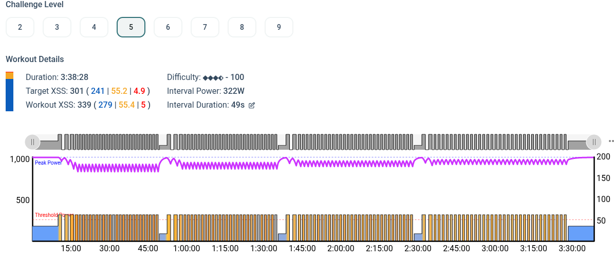

well… now Xert wants me to do 55 XHSS in one workout, 3 hours of intervals…
never heard about accumulating ~90 minutes of vo2max time in one session…

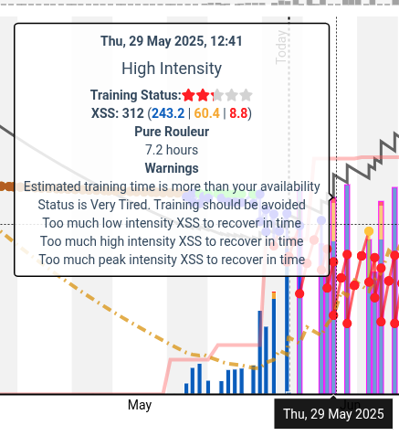

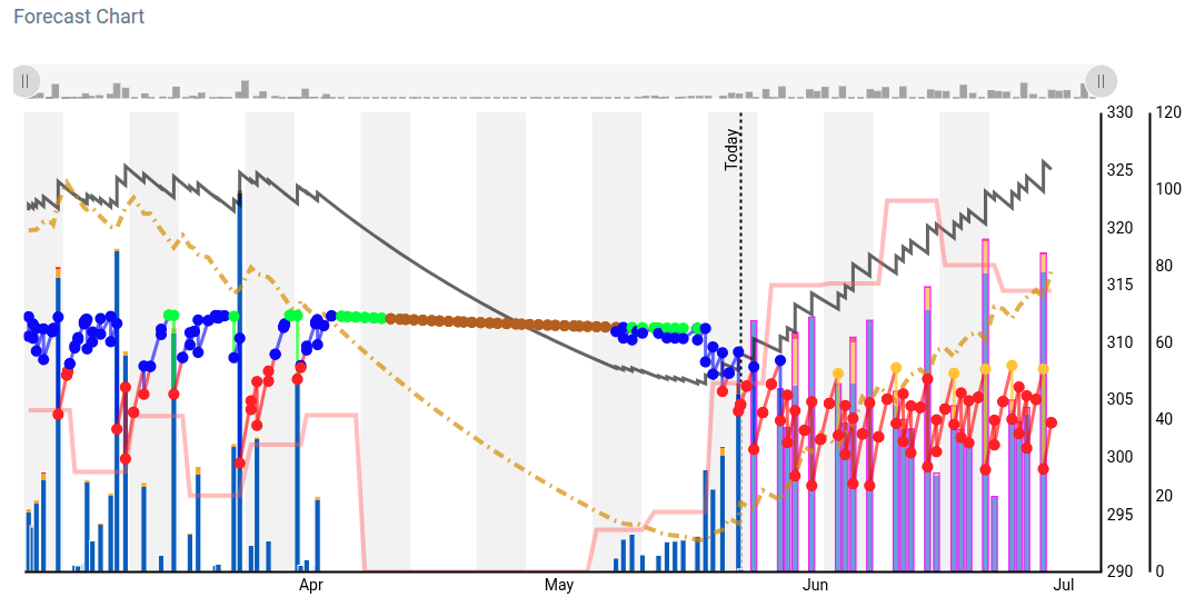

It seems you’ve fallen behind on your program so ‘Adapt Forecast’ is simply trying the best it can to get you back to where you were forecasted to be by this time. If you wanted, you can share your Forecast Chart or screenshot of Program Tab.
If I were you, I’d create a new program with more appropriate targets for your current fitness ![]()

well… i didn’t ride for 6-7 weeks (broken bone and surgery). I thought it will adapt my training,
now I see those red bars with info that it’s too much
it wants me to do even 60 XHSS
Try running Adapt Forecast (since you have many activities with warnings) and let’s see what it looks like.
