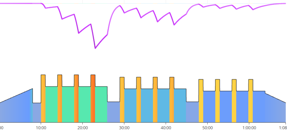

Here’s an example MB generated workout for a GC Specialist goal –
Autogen OTOH creates three sets of declining intervals to get the job done.

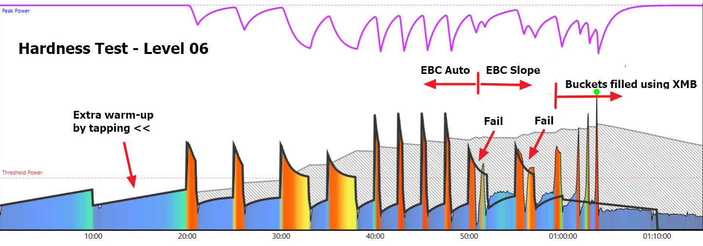

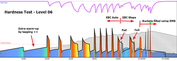

Here’s an example of a higher difficulty (3+ diamond) GC Specialist workout using Autogen –
The Hardness Test workout above was run with EBC iOS on an iPhone while I monitored XMB on my Garmin 830. The 830 was paired to my trainer (power only) via ANT+. I only saved the EBC recording.
Nowadays I mostly ride indoors with EBC Android which includes XMB. I can start with a structured workout, do my best that day, end the workout (at any time), and fill any remaining buckets with XMB.
