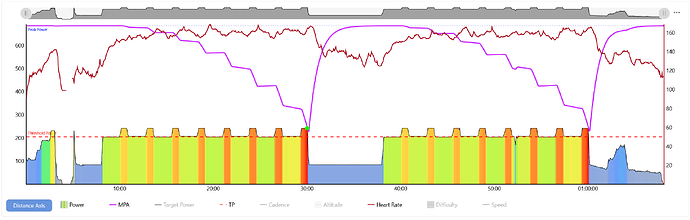

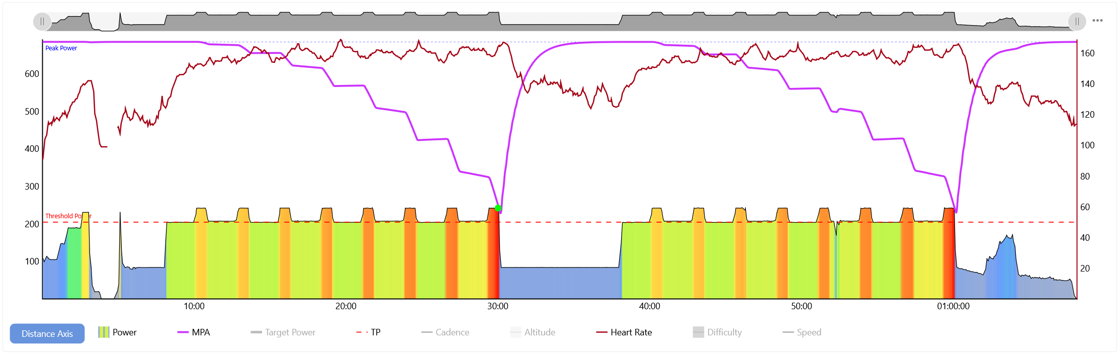

Jan 17 - 2x20m @221w

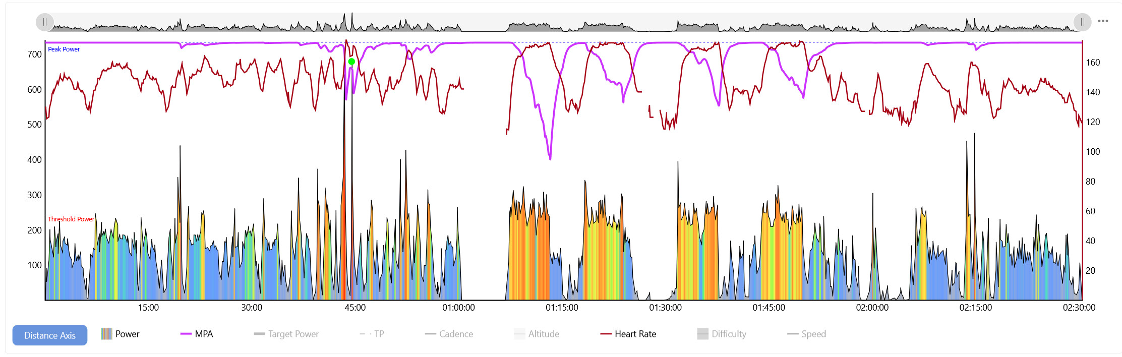

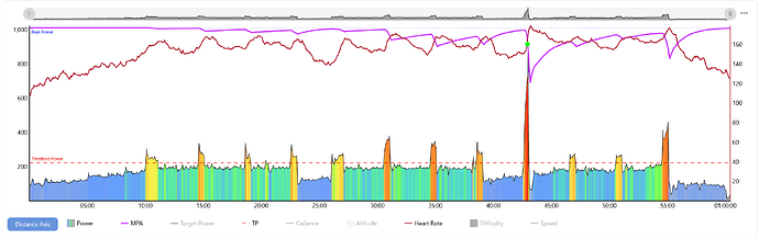

Jan 31 - the outdoor workout:

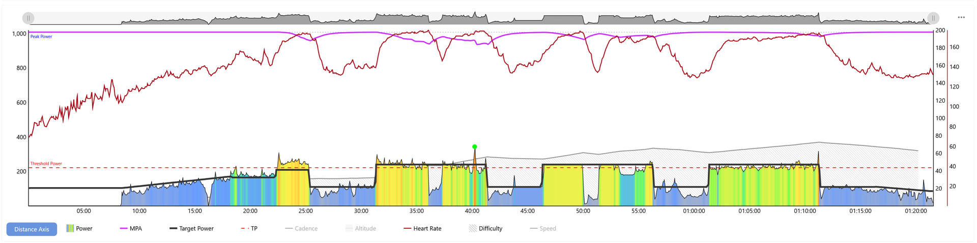

Feb 10 - BT workout after which XERT said 250W TP
At around 250W my HR is roughly at the estimated LTHR in all three rides. But without ERG it just doesnt feel like threshold work :smiley:

I decided to build a custom workout with 3x10min what Xert thinks my TP is and lets say… I had a nice productive VO2-Max workout :face_with_spiral_eyes:
5min into the first interval I had to pause for a minute and completed the other 4min afterwards. I set the trainer to ERG mode and started the second interval only to have to make a pause after 4min this time. I tried the second half but couldnt do it and lowered the resistance. The third interval I did at roughly what I think my TP is and RPE felt like I’m in the ballpark, even though I was tired by then and really looked forward to the end of the workout by now :smiley:
What else I took from that workout:
Maybe I should have a closer look at my HR, in all intervals my HR rose way above LTHR, even in the last one (I was cooked by then though). Averages were not as high in all three intervals though and I think I got a skewed understanding of where my HR goes for a given power, exactly because I made the mistake to only look at said averages.
What remains is: I still have problems holding high powers without ERG, despite fatiguing it felt easier and better in ERG. I also feel like the problem is fatiguing muscles in leg and hip because of the unnatural movement more than the effort itself. Maybe it really is just a problem of getting used to it, but then again: my knee shouldnt hurt while pedalling :smiley: I incorporated pedaling drills at the end of the workout and will continue to in the upcoming workouts and see if it gets better…
One additional question popped up while looking at the analysis:
I was really close to failure after the first minutes of the first two intervals, my MPA only dropped by 10% though - is that correct? Shouldnt it drop way more for an effort like that? Also despite being really on the edge/above TP most of the time, I only collected low XSS, but almost no HIE.
