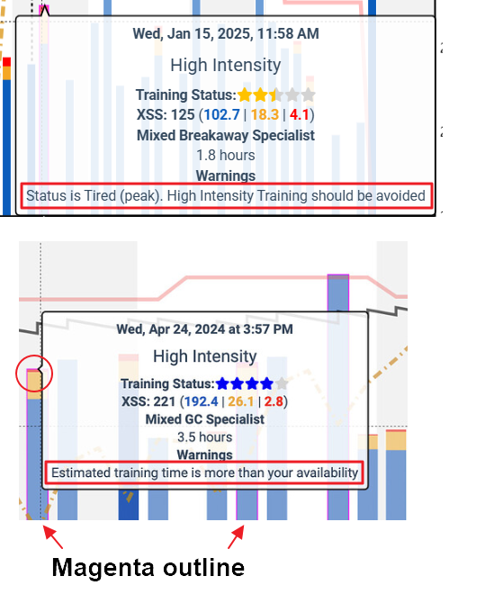

Matchstick = Low (blue), High (yellow), and Peak (red) XSS.
XSS Circle is green (low/high/peak are all close to daily target), yellow (low, high, or peak is over/under), or red (significantly over/under target for day).
Tap circle for details –
Magenta (pink) matchstick = broken constraint; hover over entry on the forecast chart to read the associated text warning; consider whether to run Adapt Forecast.
