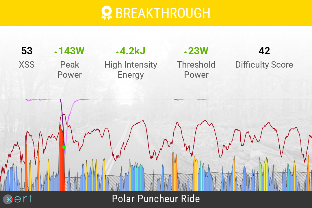

Went out the other day on a normal ride and obtained a breakthrough of about four Watts, very normal for me every so often. Went out today and smashed a PR and KOM attempt, achieved this massive breakthrough, should I be locking this out of my progression? It just doesn’t seem like it’s something I would normally be able to sustain or should train against.
I flag any abrupt stop BT where I didn’t fail naturally, and the signature bump is unexpected.
I can always validate my current signature by riding the standard BT fitness test indoors in Slope mode or a similar effort outdoors as part of a ride.
Even if no BT and can tell quickly whether my sig is in the right ballpark for training purposes.

I came up with a personal rule after having similar experiences with unrealistic Breakthroughs that pushed my TP and LTP way too high. If I’m not completely wiped out after the effort that triggered the BT, I flag the workout.
That said, it rarely happens anymore that I get a BT without being totally exhausted afterwards. I know this might not be the exact original idea behind outdoor BTs in Xert, but this approach just gives me more reliable numbers.
Otherwise, I had cases where a single sprint would push TP and LTP to absurd levels. That’s not happening anymore.

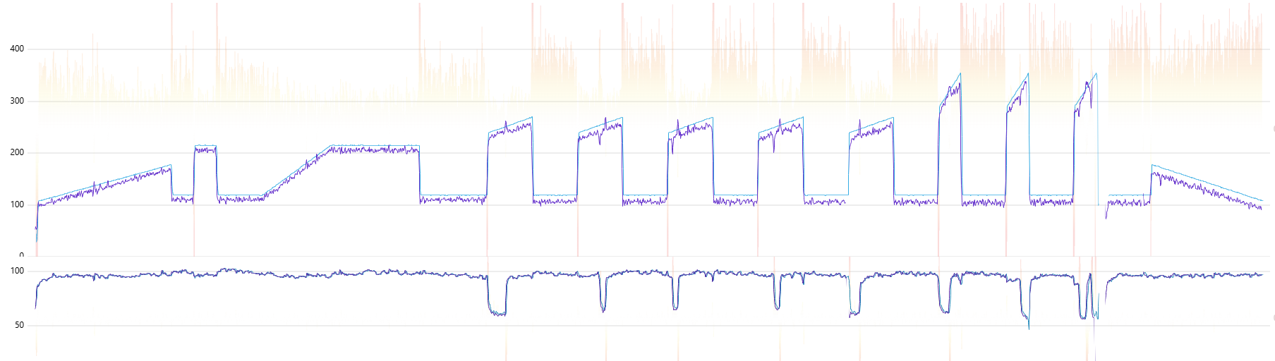

Did you dual record and use an online tool to determine 8-9% is the difference between pedals and trainer?
Do you trust the pedals or the trainer to be the most accurate?
If trainer, do the Garmin pedals allow you to configure power scaling?
I didn’t dual record, will do. Is the DCR tool the best for this?
Not sure which to trust, indoors for sure feels harder.
Dual recording and verifying results with DCR Analyzer or Compare the Watts is the way to go for an accurate delta % and whether that difference exists across the full range of watts or not.
At this point I just compared the two readings I was seeing from time to time on the screen and head unit. The Garmin pedals definitely allow scaling but I don’t know if that makes sense to do. I will do a full workout and upload into the DCR tool and see what it shows.
Did a compare - Wahoo Kickr Bike showing 13w higher on avg over the hour. About a 7.5% difference. No idea which one to trust, the graph for the indoor bike is super smooth (light blue line) while the pedals are very choppy - I can do an offset in the pedals, No idea if I should be bothering with any of this.
For a more accurate assessment you want to disable power smoothing on your Wahoo trainer and dual record again.
ok, ty
Basically the same - 10w (~6%) difference, pedals being the lower of the two.
If the Kickr Bike is showing higher numbers, indoor workouts should be easier, no? That means, you may be want to investigate more in other direction as you already mentioned. Entertainment, cooling, etc.
