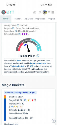

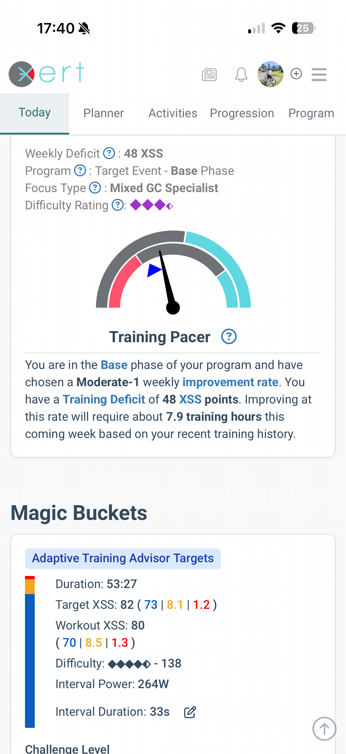

I have started a base/build/peak xata training today and xert gives magic buckets with a difficult of 138 to me in the base phase. How is this possible?
No one has any ideas? I’ve been road cycling for a while, but I’m new to structured training and thought that the base phase was only supposed to involve endurance rides. That’s why I’m surprised that xert is still giving me high and peak buckets.
It used to be BBP logic started the next day when configured with the default target date of 120 days from today.
Now it appears it is not kicking in until two days later. I’ll report the bug.
In the meantime, set your TED (target event date) to 118 days out or wait until tomorrow. :slight_smile:

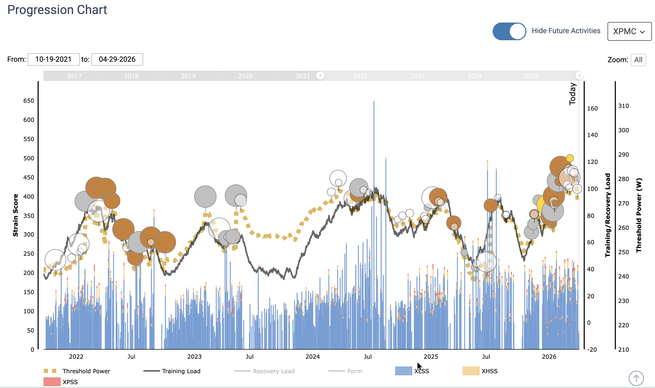

TBH, I don’t think switching decay methods will be necessary for you. Most of the existing advice on switching decay settings was made when signatures would continually decay without max/breakthrough efforts.
However, we made a significant improvement to how signature decay works back in Nov 2023 so that all signature decay settings will track with your training load after a few weeks, even if you’re not on “No Decay - Training Load Matched”.
I’ve been on slow decay for several years by this point and it’s done a great job of tracking the ups & downs of my fitness over that time:
One thing I would add… The signature decay tracking improves as you achieve more breakthroughs over time, which can be a benefit to pushing for them more frequently.
