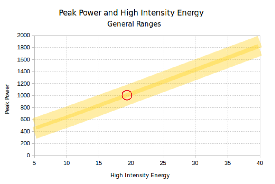

All population stats are subject to a bell curve. Example –
