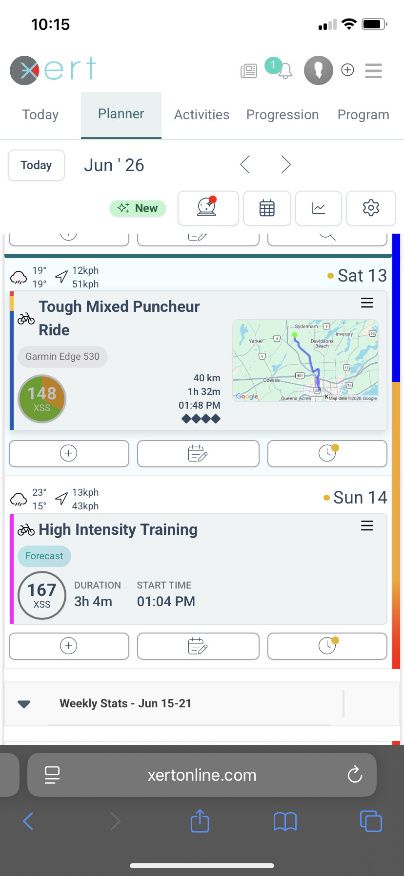

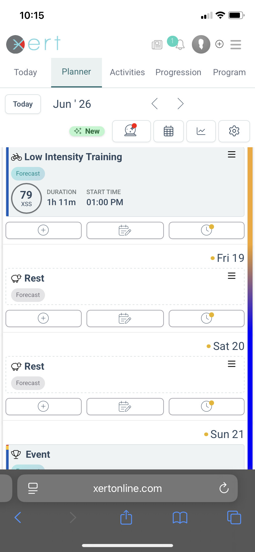

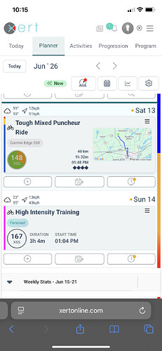

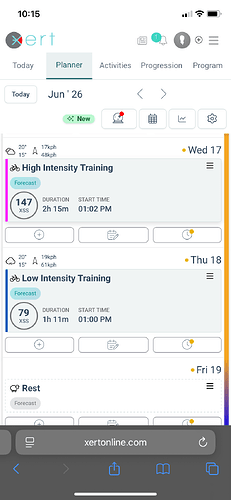

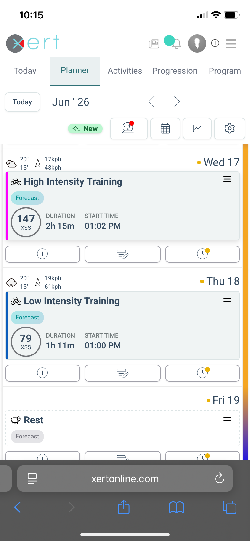

My last week of my ai race plan is considered a taper week yet AI has 4 high intensity workouts in five days with 2 rest days before a 3 hour gravel race!!! Taper is not what is planned! This needs to be fixed in the future! This the second time the AI plans overdoses prior to an event not impressed!

Today I did the manic bucket version! The pictures are out of date order. Should be 1,3,2

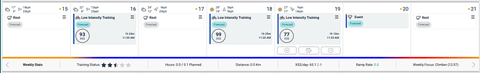

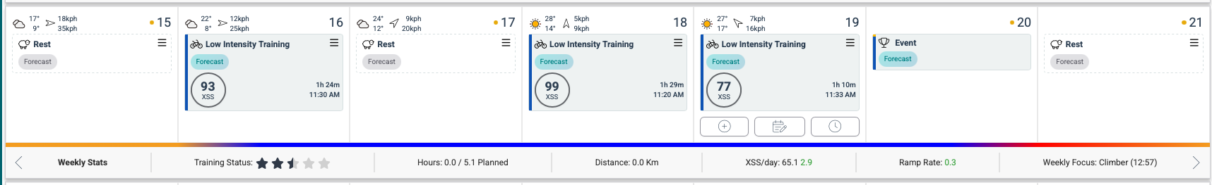

Now the calendar has changed and has a 2.5 hour high intensity workout the day prior to my gravel race!!!WTF!

For a weekly screenshot on a phone switch browser to desktop view and rotate to landscape mode. Like this –
Post the event week and the week prior.
