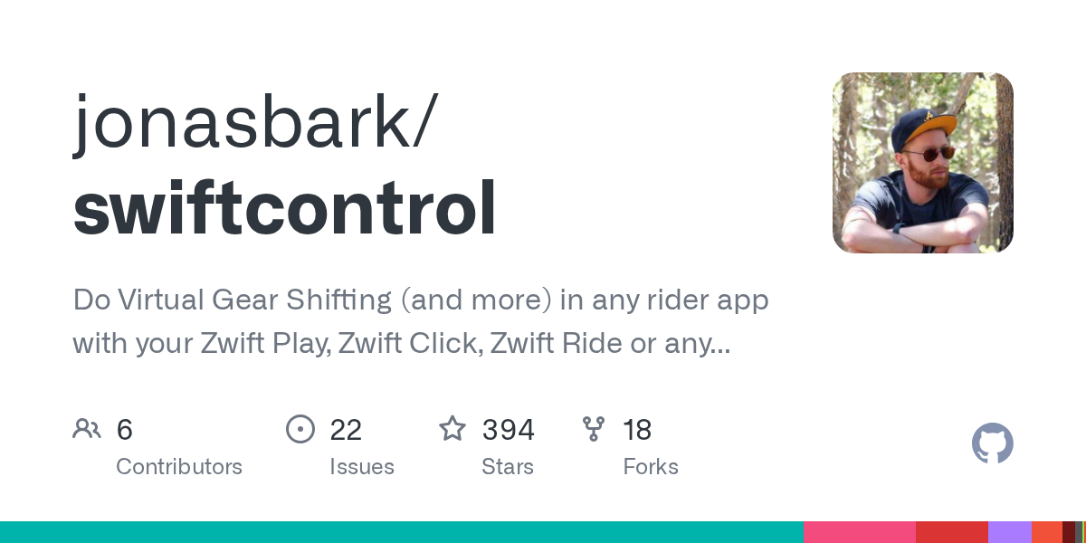

I’ve been playing around with the BikeControl (formerly SwiftControl) application on both PC and mobile to enable the use of Zwift Click hardware to control virtual shifting in other apps, although I haven’t tried it with EBC on the bike yet. (For anyone just wanting to test the app, you can download .zip, apk, etc directly from the app’s GitHub repository and manually install them, as well as purchase automatically installable versions through different app stores.)
My thought was that when doing a mixed mode workout in EBC to adjust the slope manually in the app to get the effect of virtual shifting, and use a third party interface like BikeControl to tie the Zwift Click to the EBC button presses.
However from some quick testing with EBC, it seems like slope cannot be changed from the auto setting in a mixed mode workout. So using auto mode, a workout starts in ERG mode @ 100%, then changes to slope mode @ the slope defined in the workout file. But pressing the +/- buttons does not change the slope, but instead continue to change the % difficulty. It is possible to change the mode from auto to slope during the interval, and then the +/- buttons will change the slope.
Slope I think defaults to 0% unless you have previously adjusted it, so if wanting to use it manually during a mixed mode workout you would need to ensure it was set to a % matching the workout file or some other positive value that would be a good starting point for a sprint.

Thanks for listening. I really think there is some intermediate level of single cog / virtual shifting compatibility that can be implemented without Xert having to make direct BT connections to other companies hardware. Also, FWIW, the BikeControl developer has proposed and made an open protocol in an attempt to standardize communication between hardware and trainer apps, although no one has used it yet aside from him. https://openbikecontrol.org/
Hi Brent,
Thanks for sharing all this, including the Github depository. I will be passing this along and perhaps we can do some more internal testing on our end.
